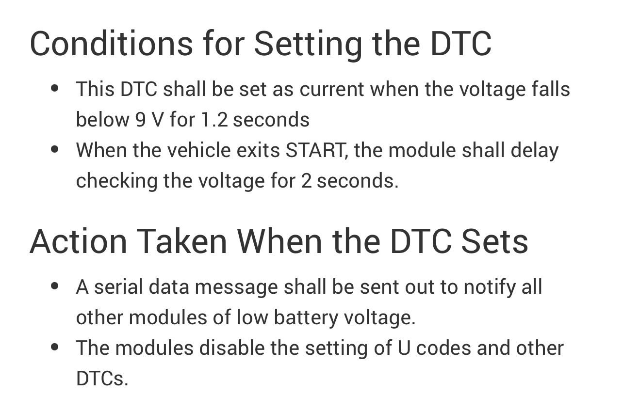

While looking over a C6 that is for sale, I scanned it and the following codes came up.
Both showed DEVICE POWER CIRCUIT LOW for the ECM and SIR. The AC was on and the car was showing 13.2 volts on the dash readout. I was able to clear the codes and they didn't come back on after a restart.

If the car is for sale it’s been sitting around so it most likely had a weak battery and when started set those 2 DTC’s…I wouldn’t worry about it and also it didn’t come back.
