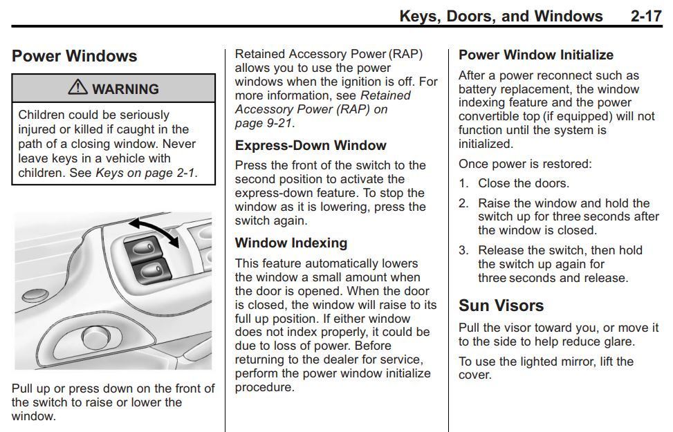

I changed my steering wheel with the same type only nicer looking and now the power top isn’t working, pull-down not releasing. I checked the fuses under the dash and all are good. Any ideas greatly appreciated. Thanks
PROBLEM SOLVED…… all I had to do is re-index the windows.

So what is the official process to index the windows? I disconnect the battery off season so I will eventually need to know.
It is in the owner's manual.
Whether it's the official procedure or not, here's what I do:
Run the window all the way to the bottom. Run the window all the way to the top and hold the switch for a few seconds. Release the switch, then immediately push the switch up again and hold it for a few seconds. Do the same thing on both windows. Done.
Starting with the window fully down is likely not necessary but my F-150 has a learn feature for both full down and full up so it's easy to just remember that one procedure that works for both.
I found it. Thank you!
For the curious, this is page 47 in my 2013 owner's manual.
