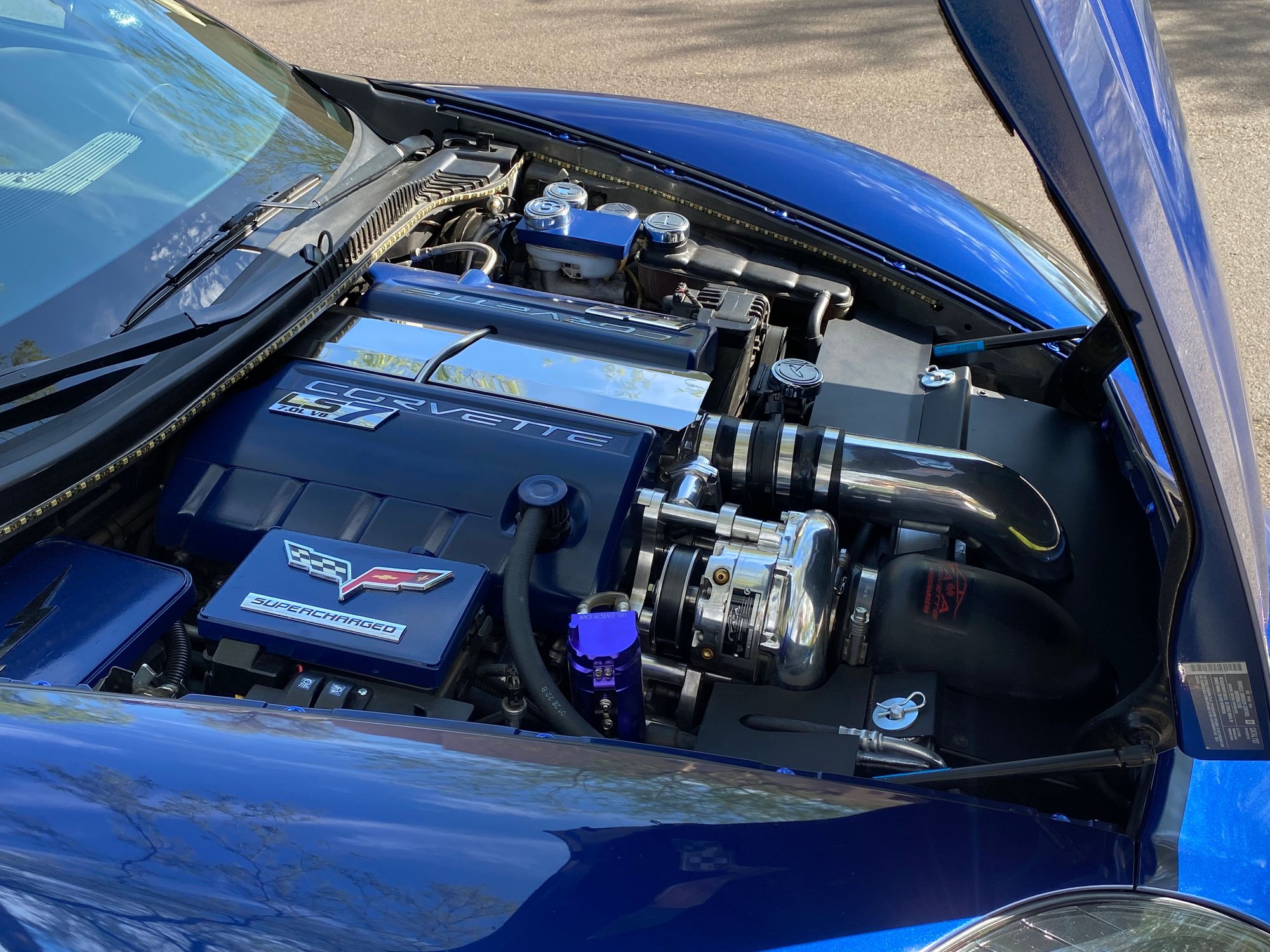

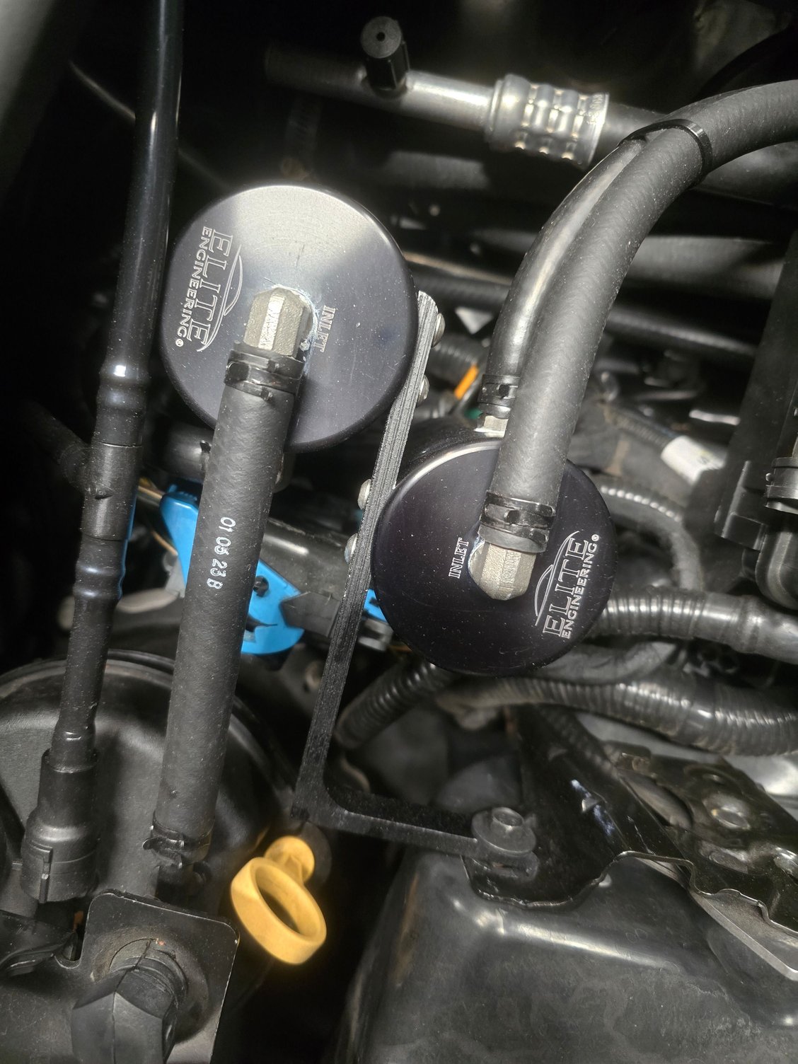

Thx for your response. Here is how we ended up...
WOW! That is a very nice setup. Looks great! Did this take care of your issue as well?

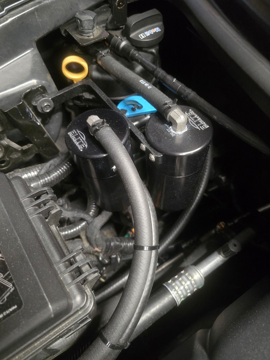

Default Catch can works well
This catch can works well with the A & A S/C and ported and polished heads, Belanger Custom Tri-Y Headers and exhaust.
Thx Buddy. I think it solved the issue but time will tell...
Very Nice...
