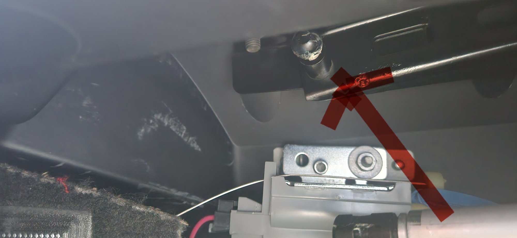

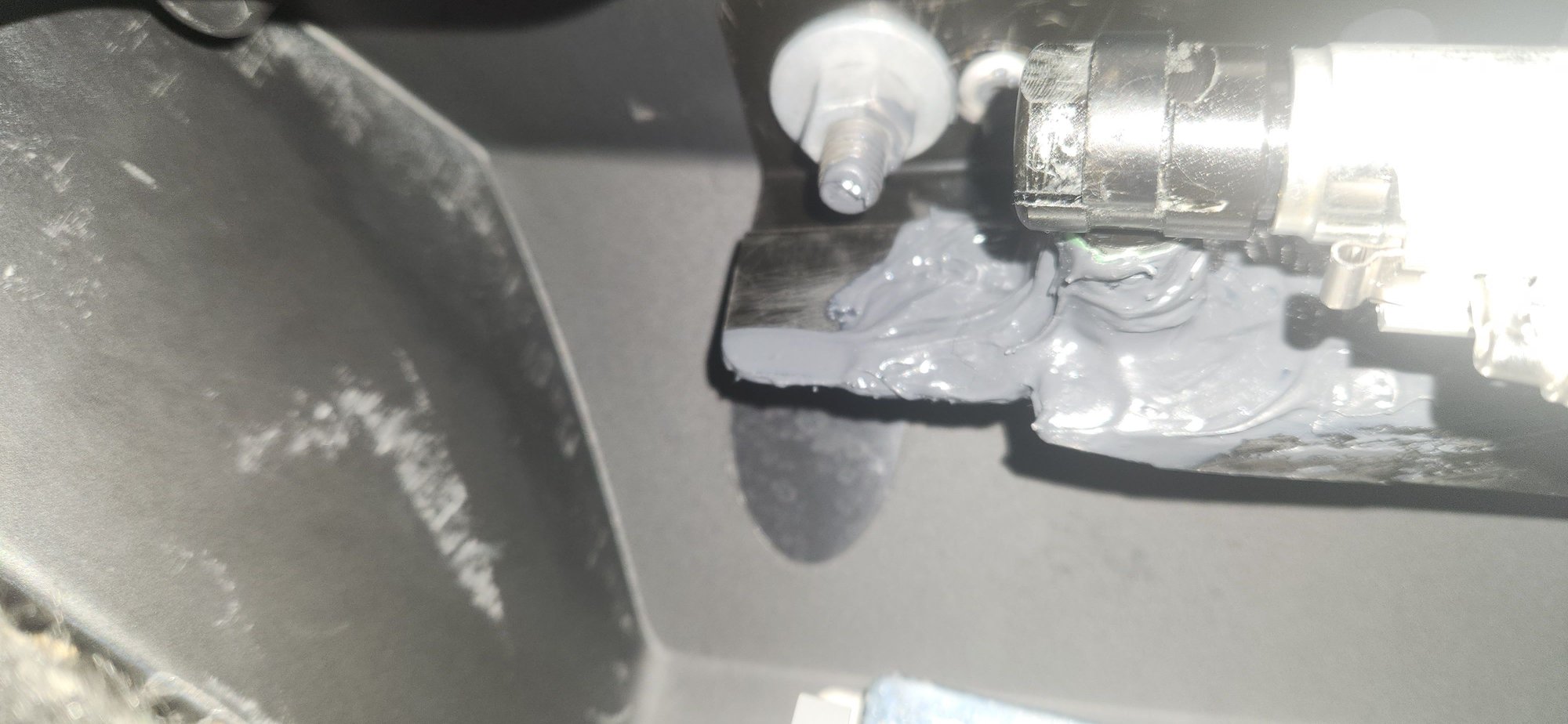

I did find a solution on my 2005 C6 top issue. The cause of my front bow hitting the tonneau cover latch was a rivet came loose on the drivers side tonneau cover cylinder ball joint post located in the trunk I discovered the problem only after removing the cylinder from the two attachment posts. The loose rear rivet post that holds the cylinder prevents the tonneau cover cylinder from extending fully because the post has play. I did find an easy solution however. You can remove the whole hinge to Weld the loose rivet or what I did was use an elastic band to pull the post forward. I then used JB Weld to set the loose post in place. Make sure you squeeze the JB Weld underneath the ball stud joint. Let it cure for at least 24 hours before reinstalling the cylinder back in place. Worked great for me. Front bow now clears the tonneau cover latch.
Fyi the rear window hitting the tonneau cover is a different problem that is repaired by tightening two straps by about 3/4 of an inch. Theres lots of videos on utube to instruction on how to on this problem.
There is nothing on line about my repair to fix the front bow which attaches to the front windsheild hitting the tonneau cover latch while retracting or putting the top up. I'm excited to share this as it took me 3 years to figure out. A shop would have cost me a fortune to figure out.

I'm super glad to help. It sounds exactly how my top acted. I was surprised and relieved to finally see what the unexpected problem was. You will need to check both sides of course. Hydraulic cylinders on passenger side and drivers side. The drivers side has the micro switch that tells the cylinder to engage. Fairly easy to get at both sides. I've had another thread saying that was also the problem with their vette. His rivet was loose on the passenger side. There's are two excellent utube videos from Klaus from Top Hydrulics on operation on the all the cylinders, pumps, etc. He shows how to get to and remove the cylinder/cylinders from the truck. Real easy, but really shows what to do. JB Weld is a great product if used correctly. Took me about an hour to fix. Hope the pictures help. There's really not much adjustments on these tops, so I willing to bet that's your issue. Those posts should have been bolts instead of riveted. Factory flaw. Fingers crossed. Keep me posted. Cheers.
