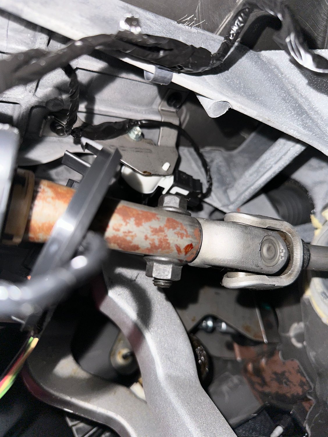

Hi all,
new to me 2011 grandsport with the dreaded service active handling message. Pulled code C0710 and went to clean the connection/ zip tie the connector to the sensor.
upon pulling the kick panel I noticed the sensor housing was loose on the shaft and the retaining ring also just loose free-wheeling.
imagine someone has been there before and didn’t deal with it correctly…
here are some pics - where do you suggest I go from here?
tried snapping the retaining ring back into place but I can’t get it to seat for some reason.. very difficult to see the backside so I’m assuming I’m not aligning it correctly or it’s broken (all the tabs seem in place)
see pics and let me know please!
