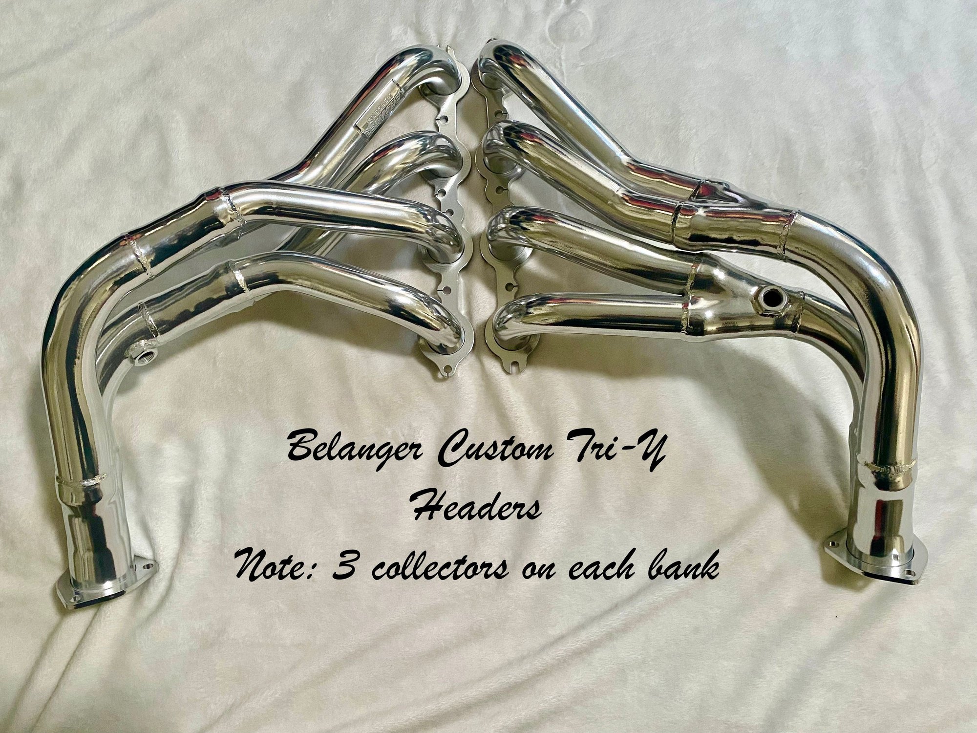

The best bang for the buck would be the S/C.......I installed my own A & A S/C.......very reliable, and immediate hp. I also installed Belanger Custom Tri-Y headers, and exhaust with high flow cats, no check engine light. Lou Belanger is a master fabricator. Had the Belanger's on both of my Vipers too, and created incredible hp gains.
A & A S/C ...LS7 short block......machined to 70cc cathedral ported and polished heads
The finest headers money can buy, custom fabricated by Lou Belanger
Incredible install with headers that fit perfect...installed myself.

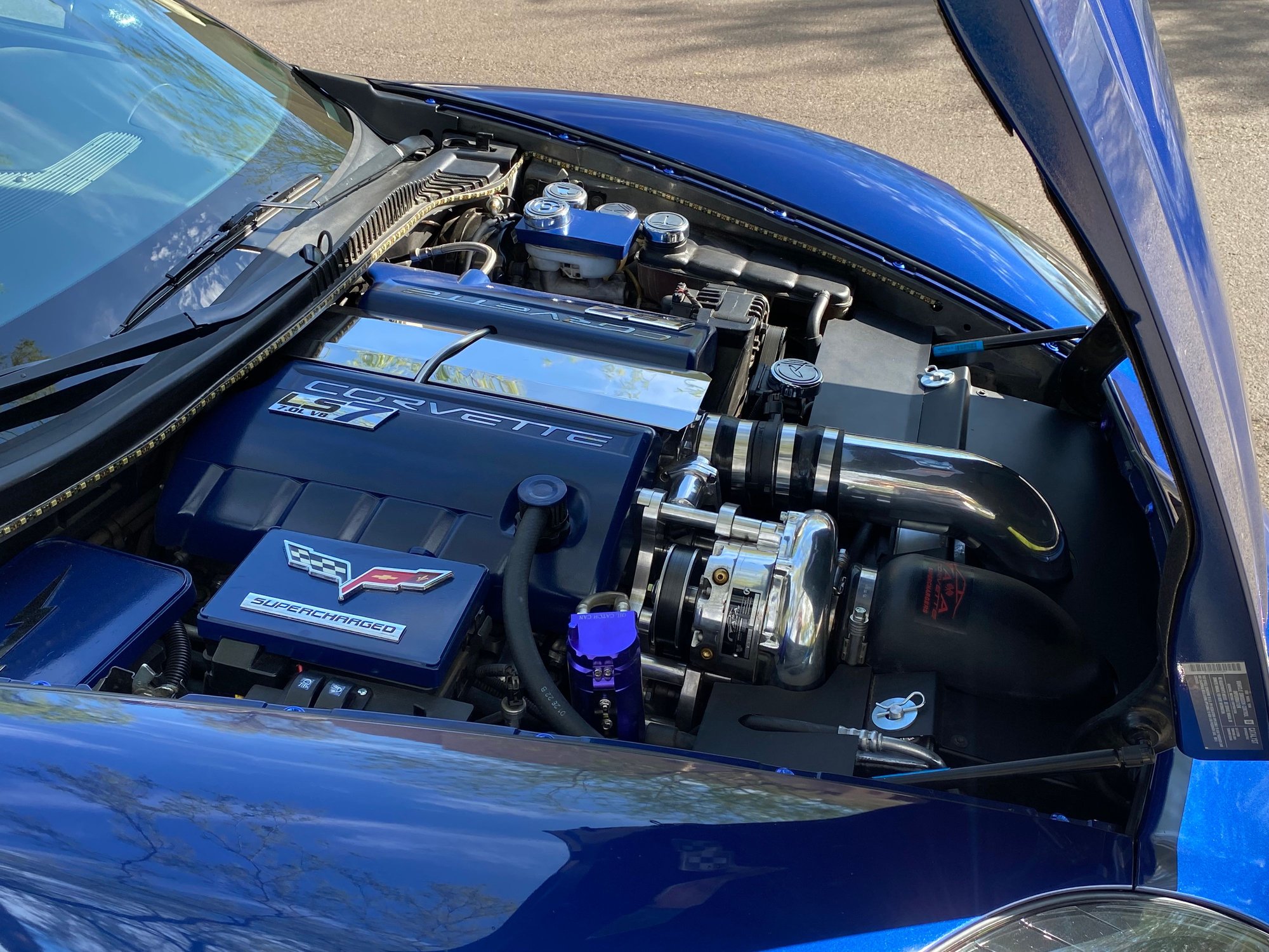

I put a supercharger on my LS2 auto and made 582 rwhp. Only other engine mods were an electric wp and carb legal shorty headers. I think I paid right around $13k for the supercharger and install, the electric wp and new harmonic balancer.
That still leaves you $4k for new wheels and tires, even more without doing the wp and balancer but I suggest definitely doing the balancer if not already done.
