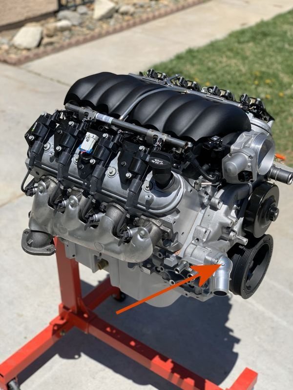

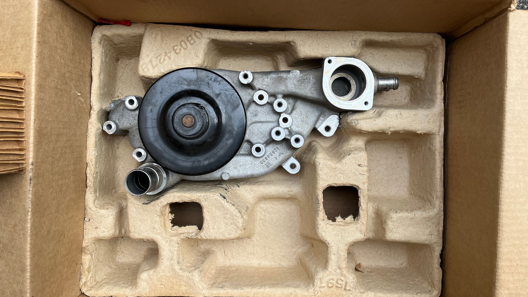

Another old guy here. It’s not going to be as easy as it was on the old Chevy small blocks where the t-stat sat up top under the gooseneck.
I don’t think your LS2 will be that different from my LS3, and the thermostat fits under the housing on the face of the water pump. Here’s a pic of the pump without the housing that was in my car.
I’d say it’s pretty clear where the thermostat and housing go, along with a gasket. Just make sure you get the right thermostat because there are at least 2 that are year specific. And remember, every 20 minute job is one broken bolt away from a 2 week ordeal.
