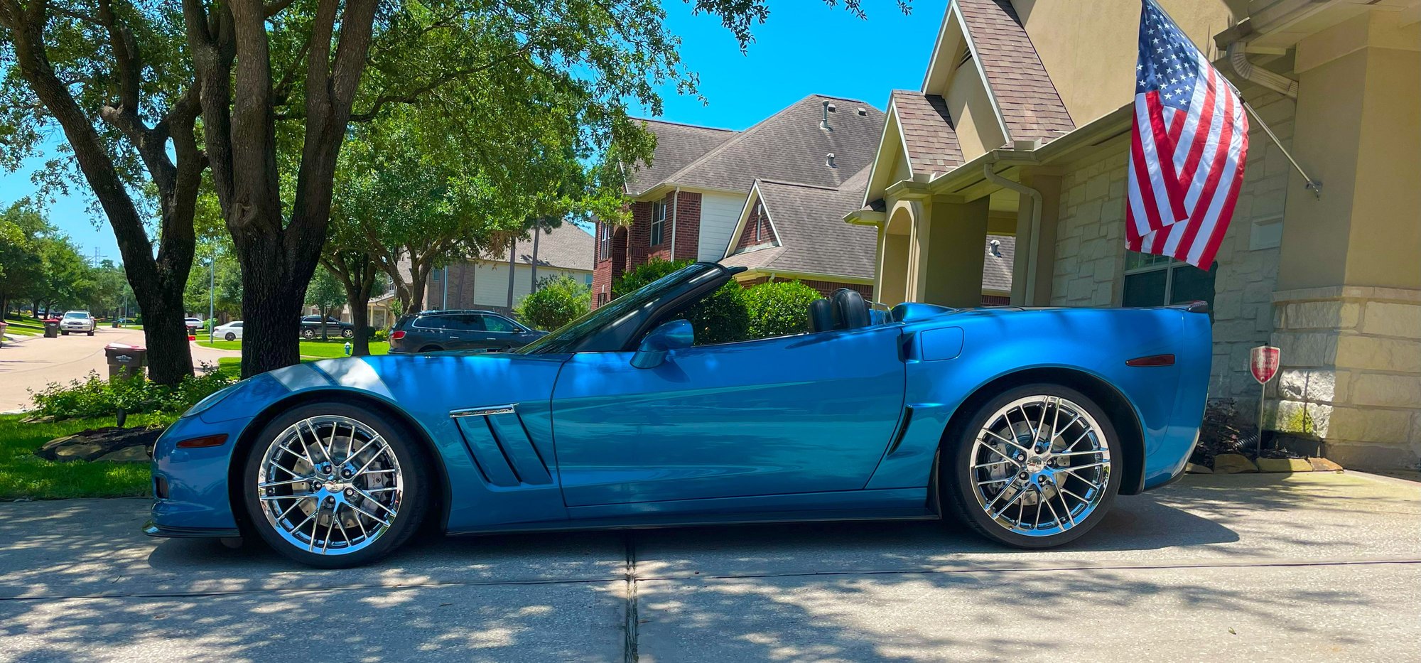

One thing I noticed when I changed from 18/19s on my Grand Sport to 19/20 from a ZR1 using ZR1 tire sizes is the overall height of the wheel/tire combination was identical. The ZR1 sizes just had less sidewall. So as long as you stick to proper ratios where the overall height doesn't change, I can't imagine it would effect handling.
