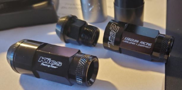

I bought these in black..they look so sweet. A bit pricy, but quality stuff! Not sure if they have chrome.
