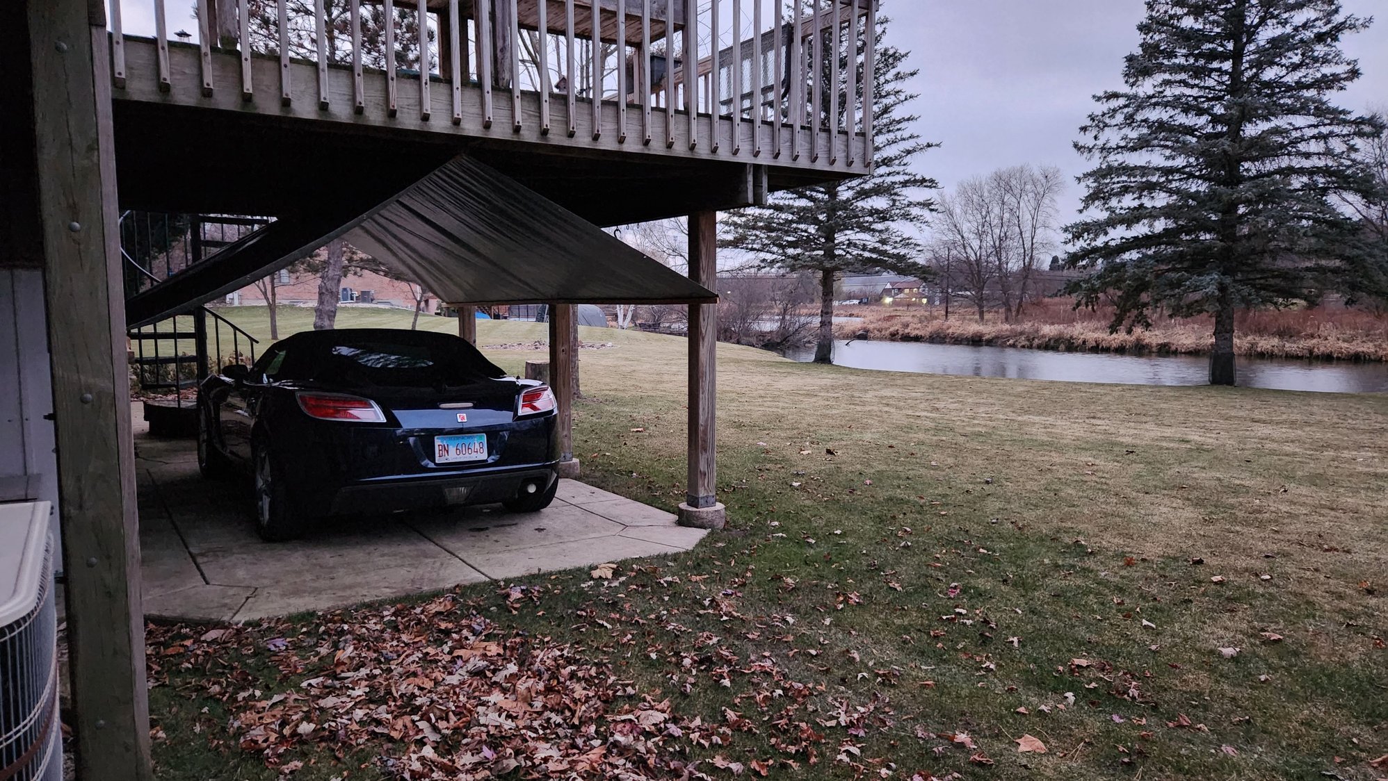

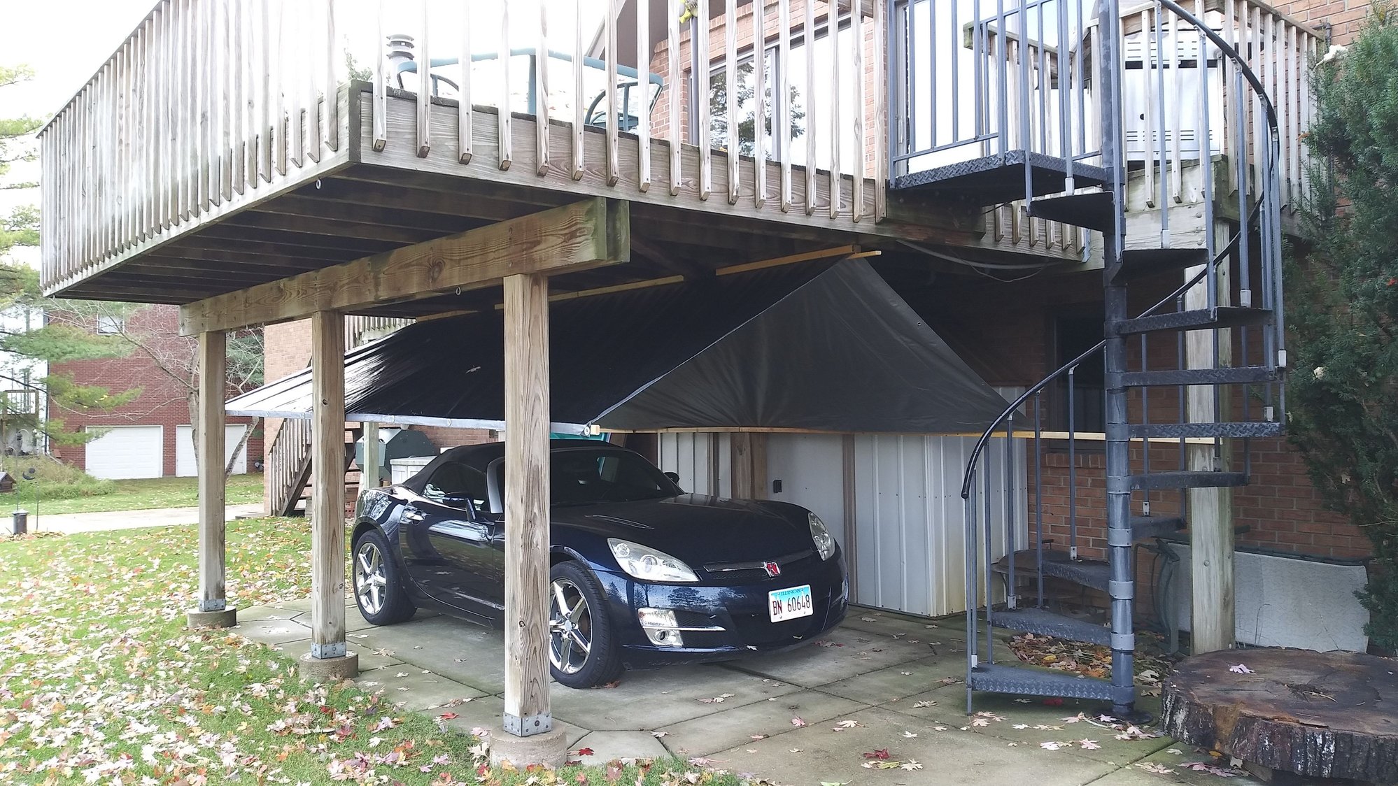

With our Saturn Sky stored outside in the elements under a canpoy in northern Illinois, I would charge the battery to "full", then disconnect the battery and leave it in the car because it is so difficult to remove the battery. I did that for the 3 years we owned the car with an unknown aged battery. Come spring time, I would hook up the battery and all was well.
Still, if the battery could have been easily removed, I would have removed it. So if you have a place inside, take it out. If not, leave the inside and disconnected. Just make sure it is fully charged.

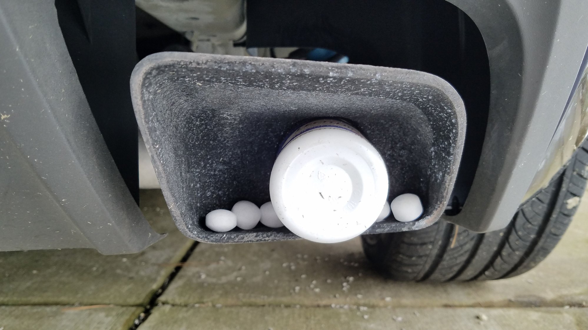

This is how I stored our Sky under our deck on the lower patio. One challenging matter was rodent infestation. Moth ***** and liquid fabric softener on rags in trays, in combination, kept them out.
