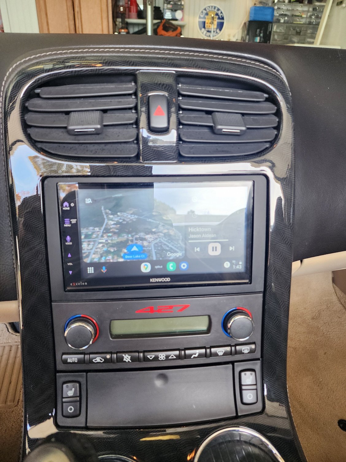

Update: I followed the advice of many here and I bought a Kenwood Radio and all the wiring from Crutchfield. It took me about 3 hours and it wasn't difficult at all to install. The hardest part was disconnecting the wiring from the bezel. It works like a charm, no more issues and it sounds good too.
Thanks to all for your help and advice.

I bought a Kenwood radio with the PAC interface. Crutchfield set everything up so it was plug and play.
