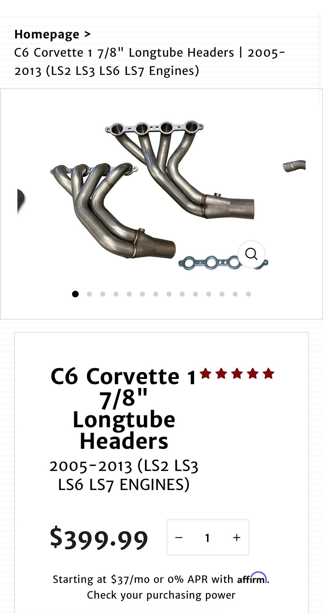

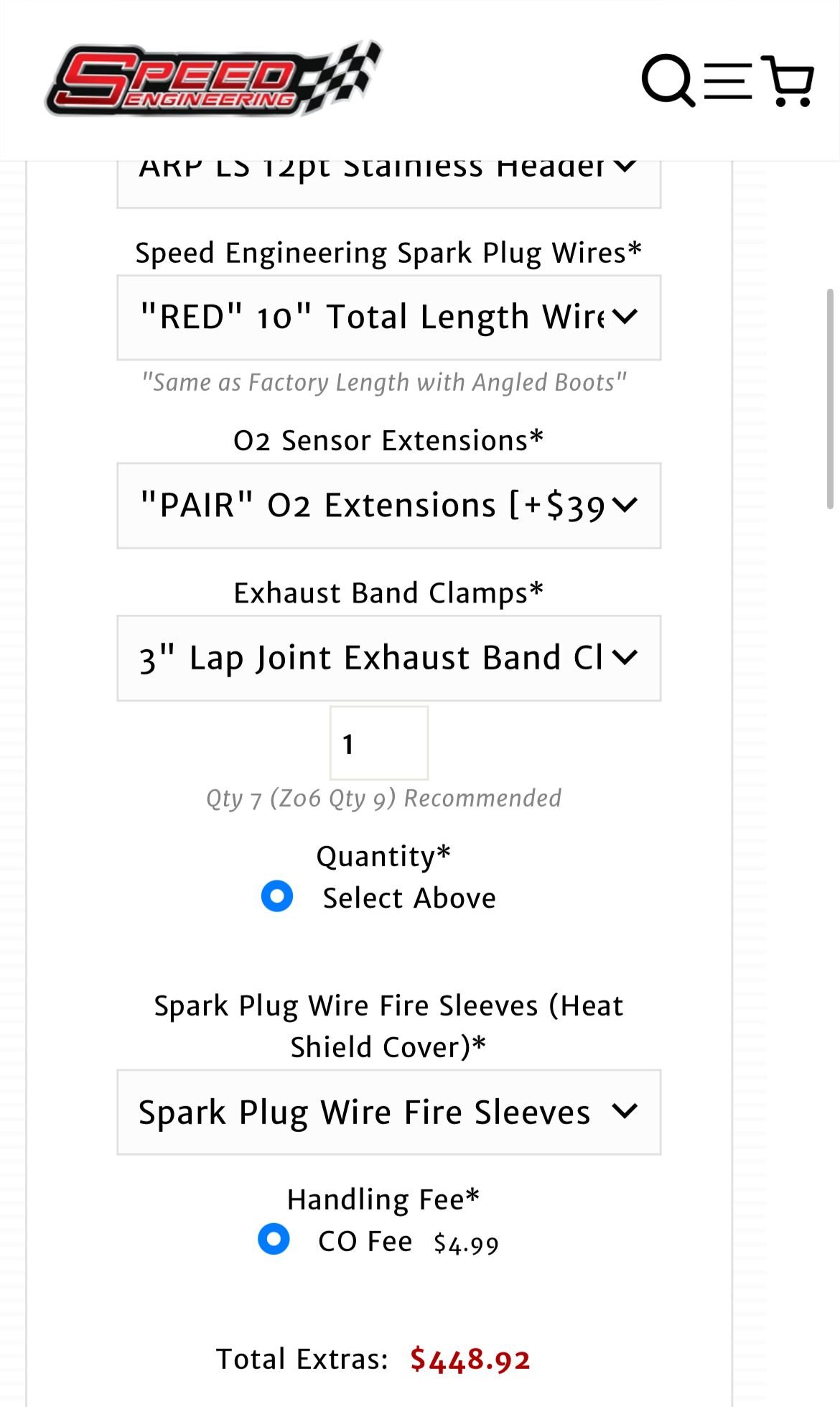

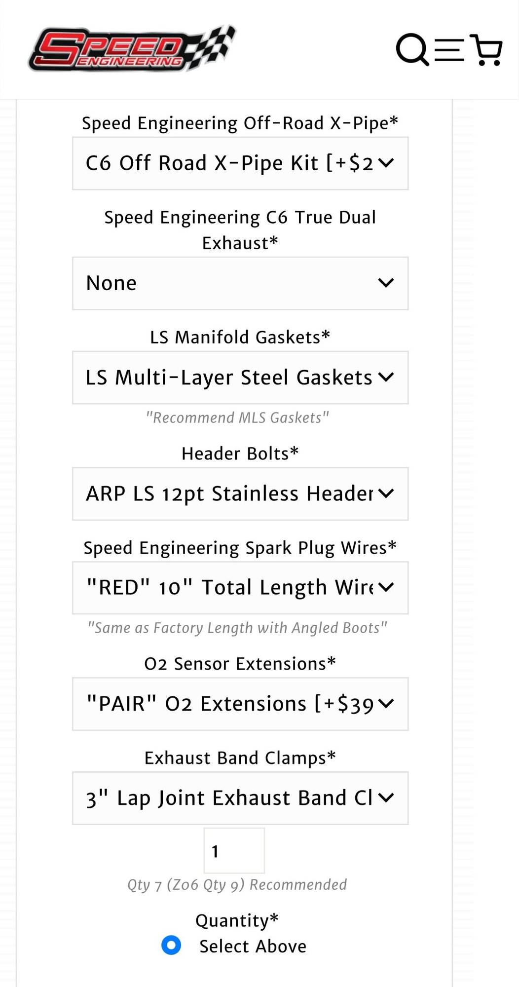

I was wondering if this is all I need when installing new headers. I dont know much when it comes to cars and was just wondering if I needed to get anything thing else or would all of this be fine.

When I was looking for headers and all the info Ive seen about speed engineering, people have recommended to upgrade the gasket and add 3" lap joints clamps. Everything else that you've picked is good.

Speed Engineering is good, when it fits. I've found over the years that fit is inconsistent. Those paper gaskets? Yea don't get those, use a factory MLS gasket. Recommend upgrading to ARP header bolts so you don't have headaches in the future. fire sleeves for your plug wires are a good idea (I see you've chosen that option). I run kooks on my car. More expensive, but you get what you pay for.
IMPORTANT when running headers make sure the fitment is good with your clutch line, o2 sensor lines, battery cables. get them all as far away as possible, there locations are hot spots anyway.

Thank you so much for your input, do you by chance know the quantity of lap joint clamps I should purchase??

Don't buy their clamps. Theirs are garbage. Buy a handful of stainless lap band clamps on Amazon.
Agree with the other recommendations of ARP bolts and OEM gaskets.
