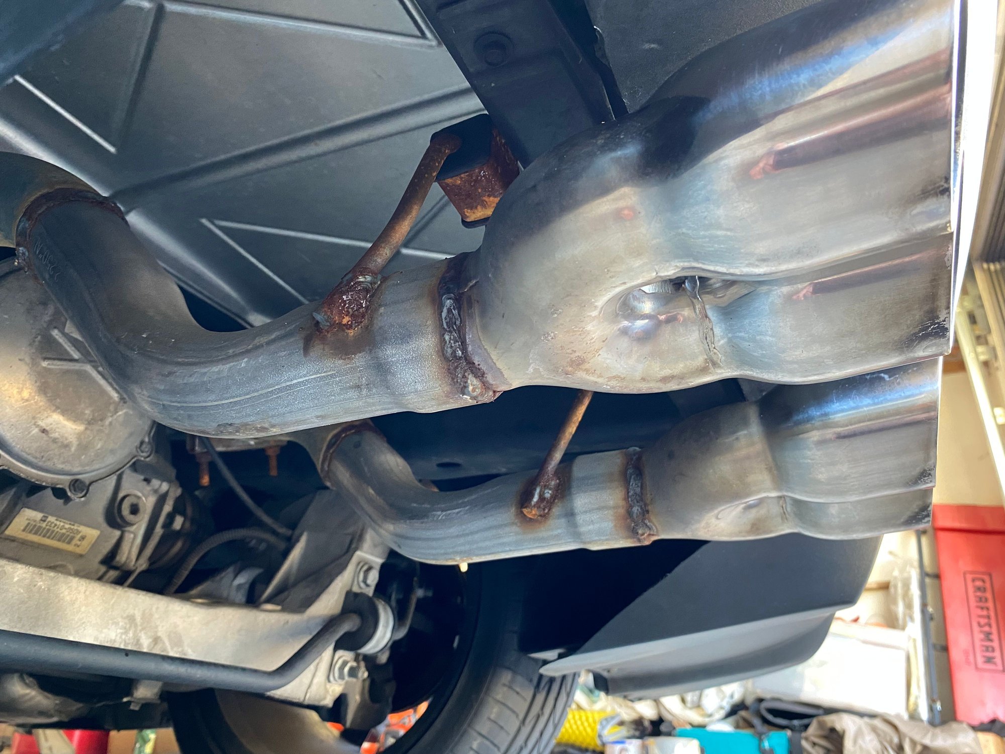

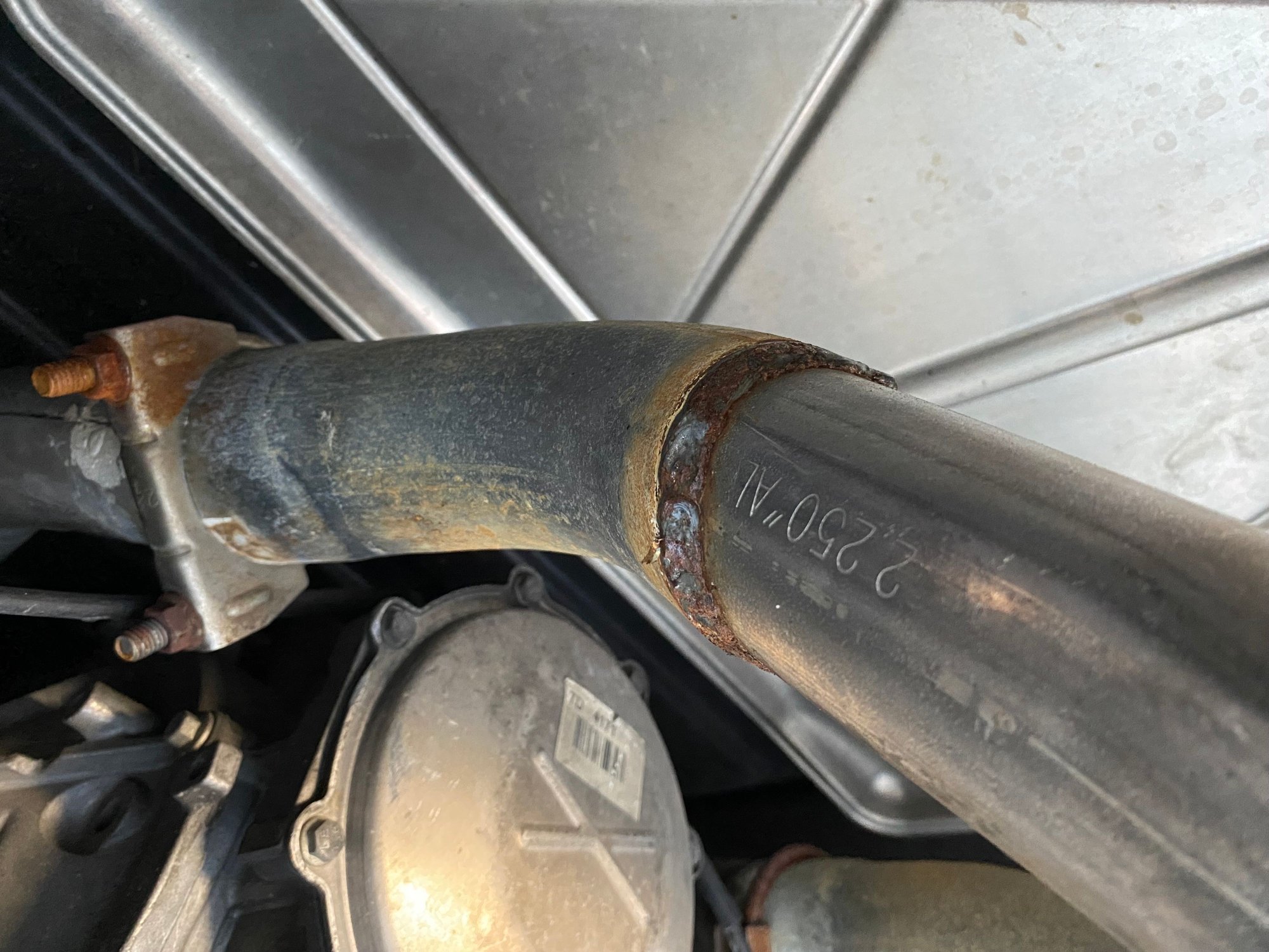

Here’s pics of the setup, it’s been like this for over a year and I didn’t realize it was 2.25” piping until I seen the marking recently. I’m just wondering if I’m losing any power because it is a small section, but in theory the overall diameter is like putting a cork in it imo.
