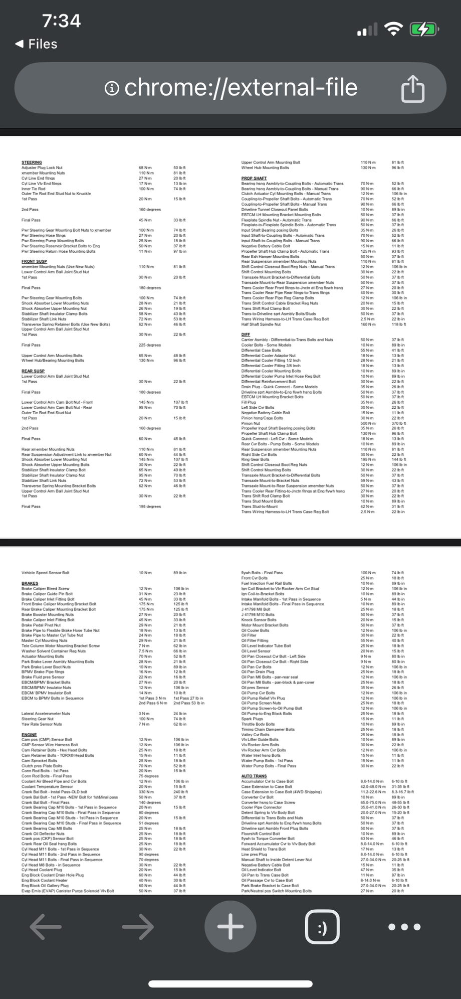

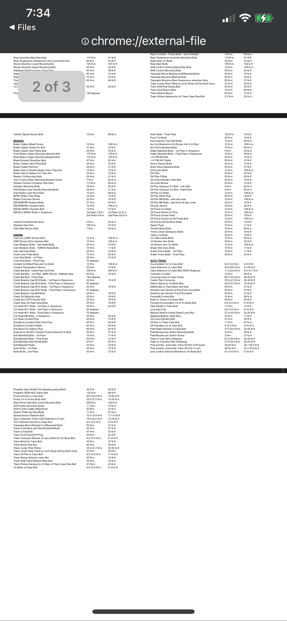

Wanted to say thanks to everyone.
I used one of the recommendations above to set the new pad height at 25mm (aka 1 inch) of bolt sticking up above the spring and that seems like it’s the perfect height for a good stance. I also think having between 25-30 mm of exposed upper bolt would be just fine.
I am uploading torque settings for the suspension here for anyone in the future who is doing this job.
