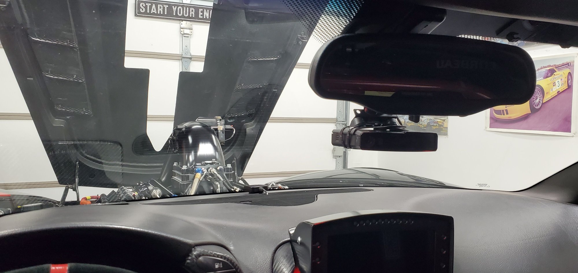

I don't know who this will help but through the years and multiple removals for various projects my rear mirror was pretty loose.
Didn't want to replace the whole mirror but saw a video where someone replaced the tension rods with drill bits.
These bits:
Drill bits Drill bits
Cut to length and it's solid as a rock
