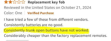

Looks like you're not alone on that. I was trying to find one for you on Amazon and ran across this on an aftermarket key fob.
