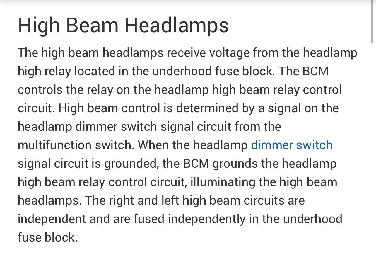

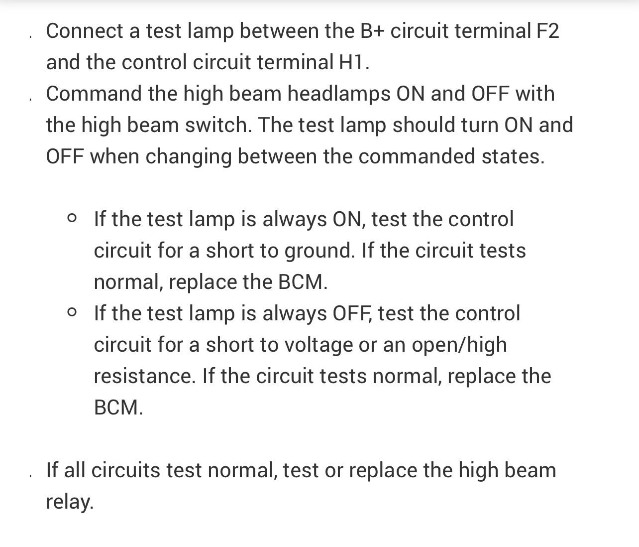

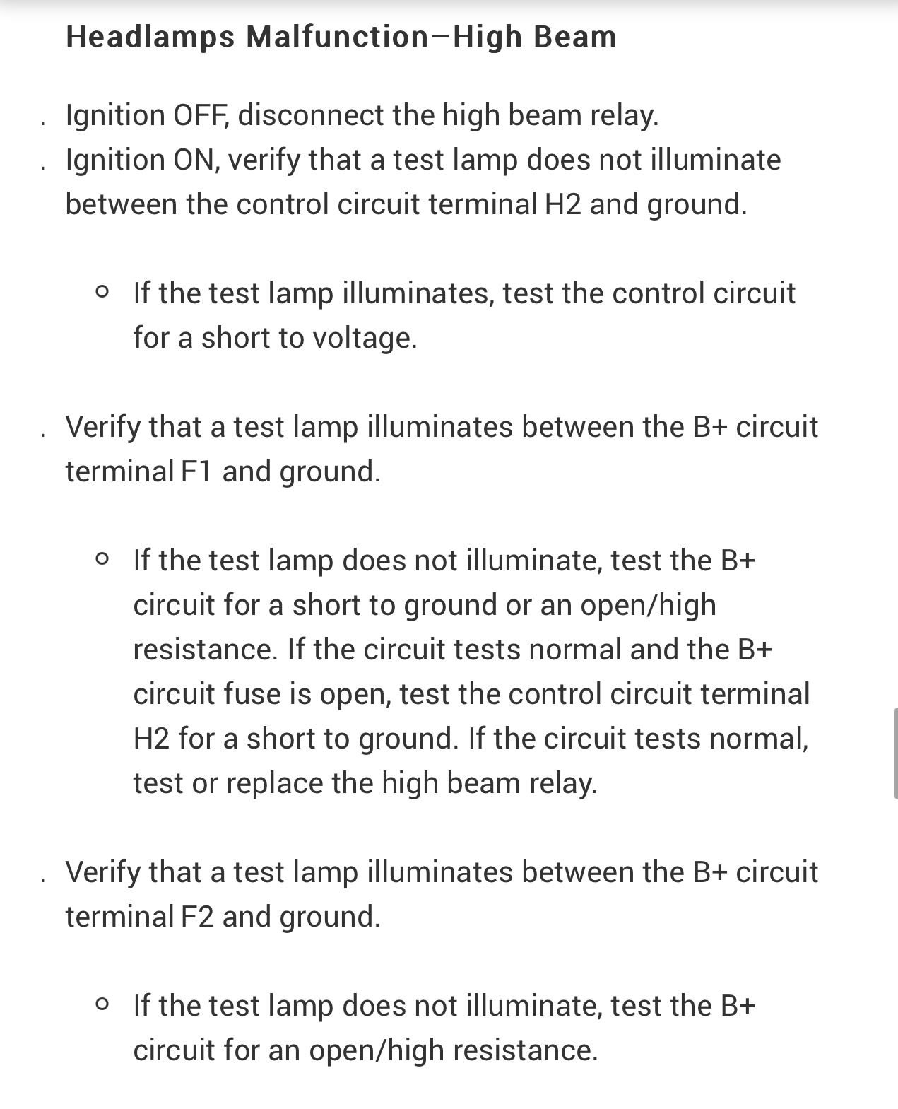

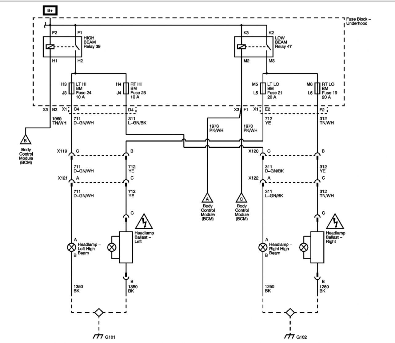

Your VSS must not have been plugged in during your clutch change…the P0650 and high beam flow charts below..also a good idea to at least let us know what model year you have…good luck in your testing !!
