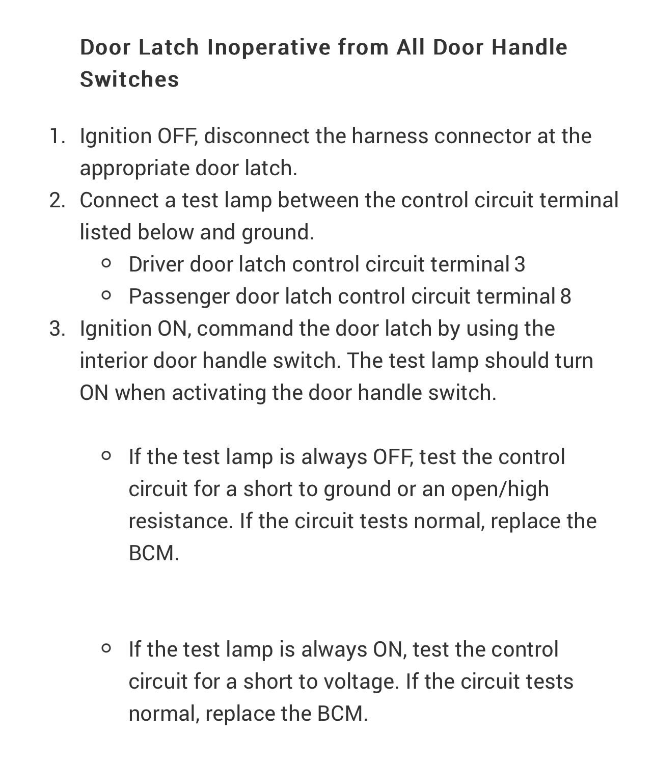

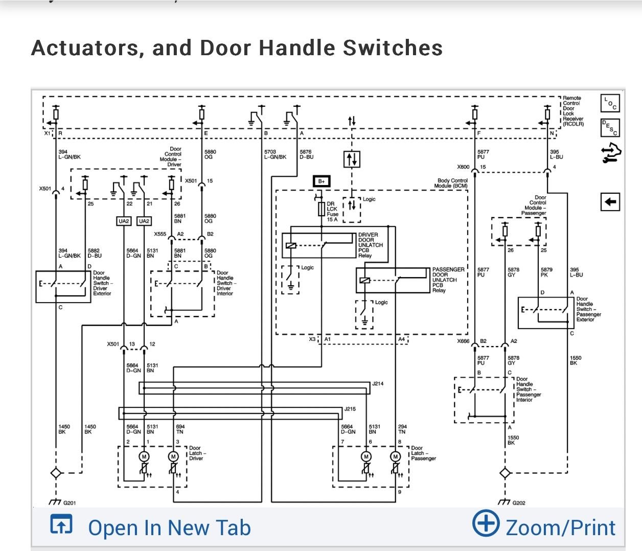

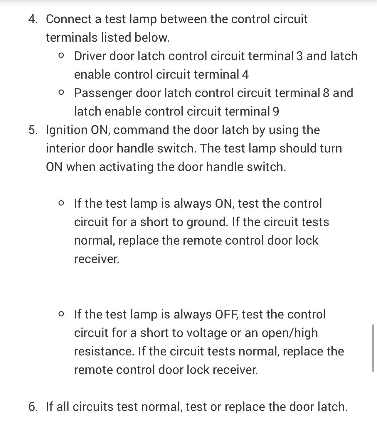

You should be looking at wiring first before changing parts…it’s best to have a factory level scan tool to look at the door module inputs and outputs…wiring diagram below but unfortunately it’s beyond the scope of this Forum to guide you step by step in this electrical diagnosis.

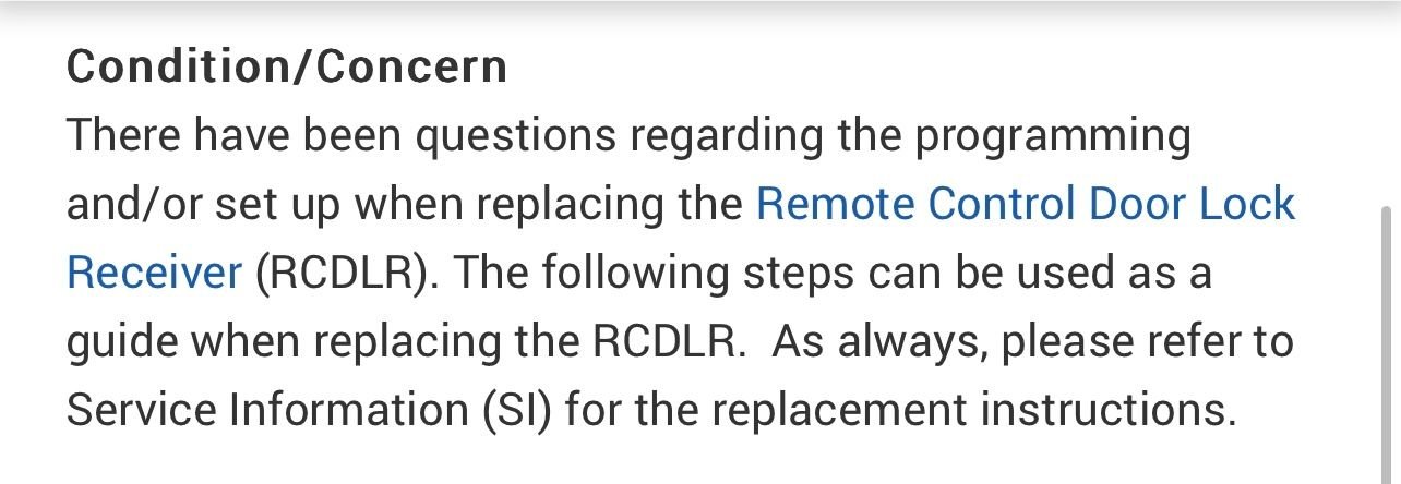

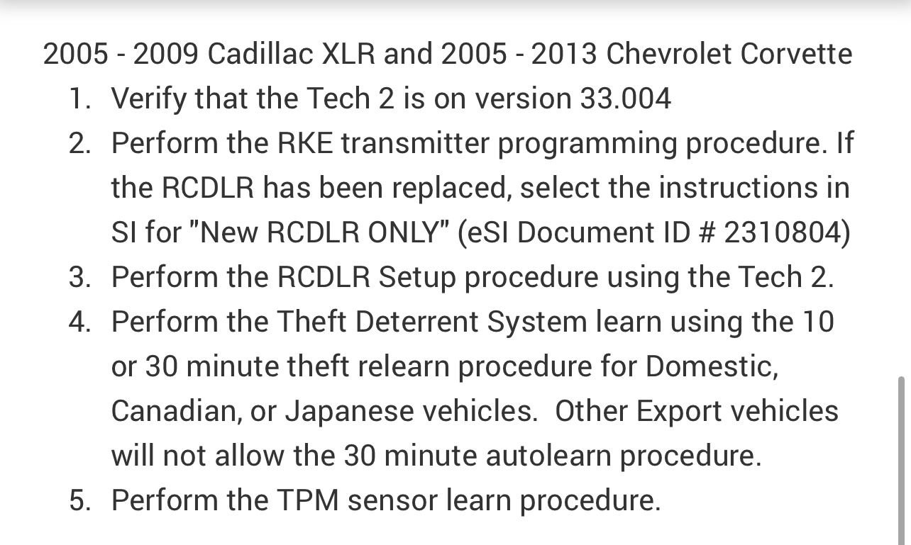

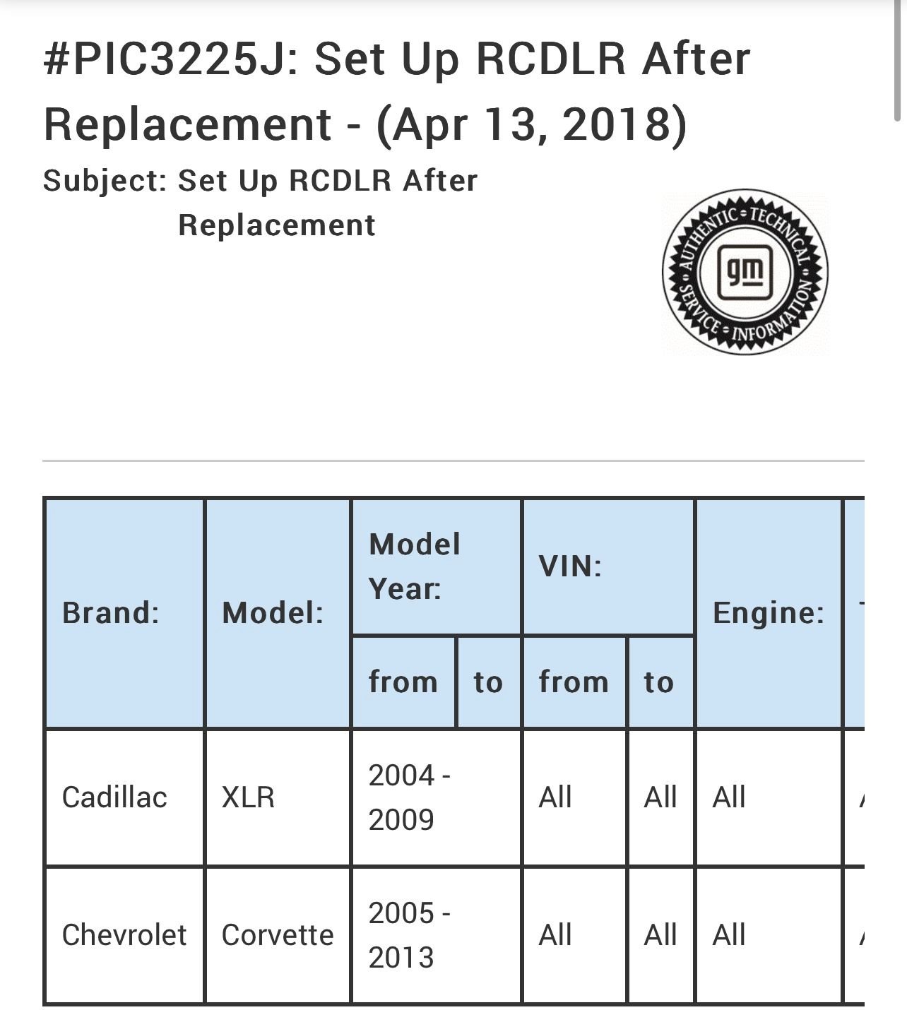

Thank you!! After alot of testing and going through this above procedures I've concluded (as the instructions say) that I need to replace the RCDLR module behind the center dash bezel. My # that is currently in my car is 25882862.
am I able to replace with another module with same part # without a tech 2 program?

Programming still required and hope you guessed right.

I found a company called "module mechanics" and I spoke with a person there a few minutes ago regarding their refurbished units and they stated they are 100% plug and play and no reprogramming would be required.
I'm not 100% certain as what to do at this point.

My car currently doesn't have TPMS sensors either so I would hope that woukdnt stop them from being able to do the programing...

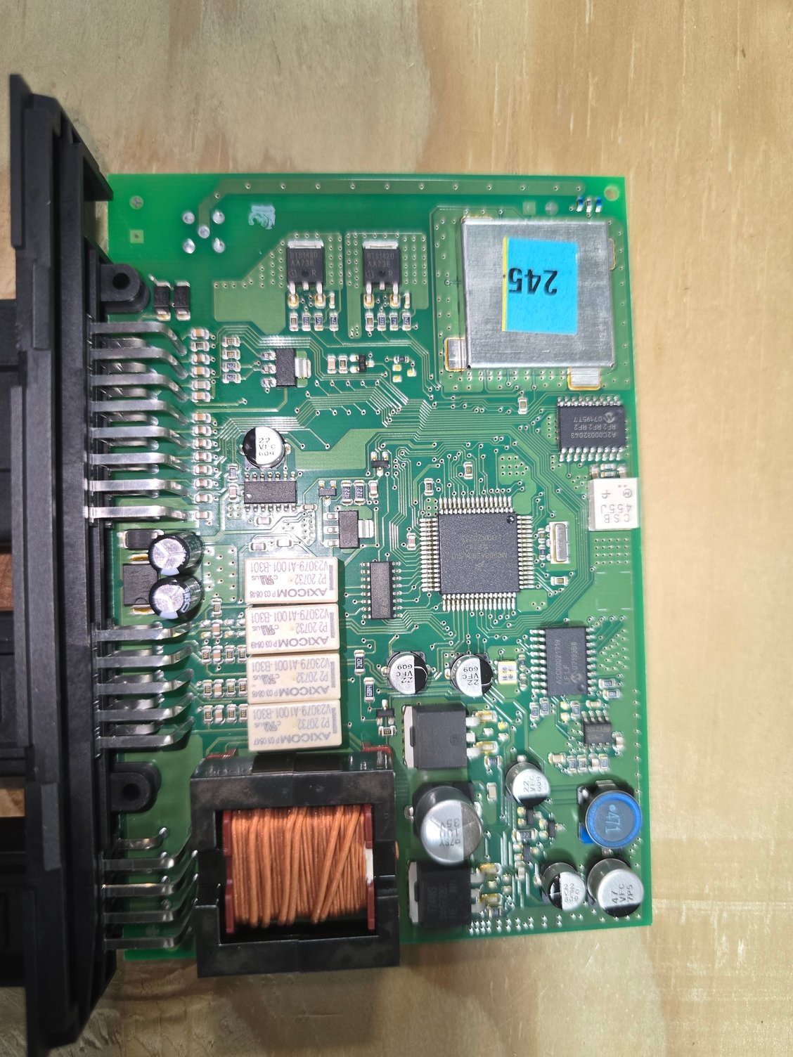

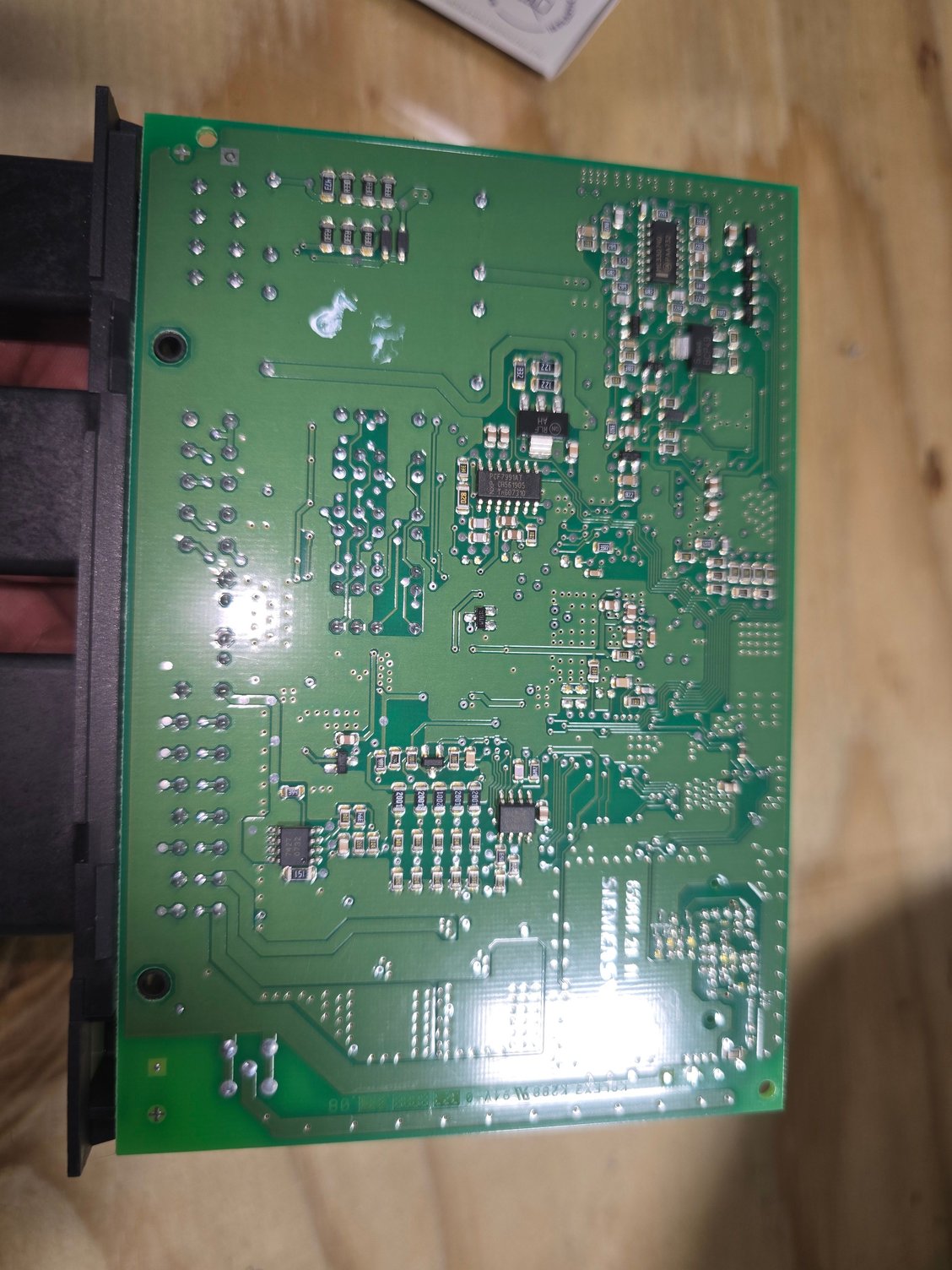

Old Mar 22, 2025 | 12:21 PM
sick cc's Avatar
sick cc
Joined: Apr 2012
Posts: 463
Likes: 5
From: Salisbury PA.

Lost here, since your showing the RCDLR board, which should not have any part of the problem over all.
