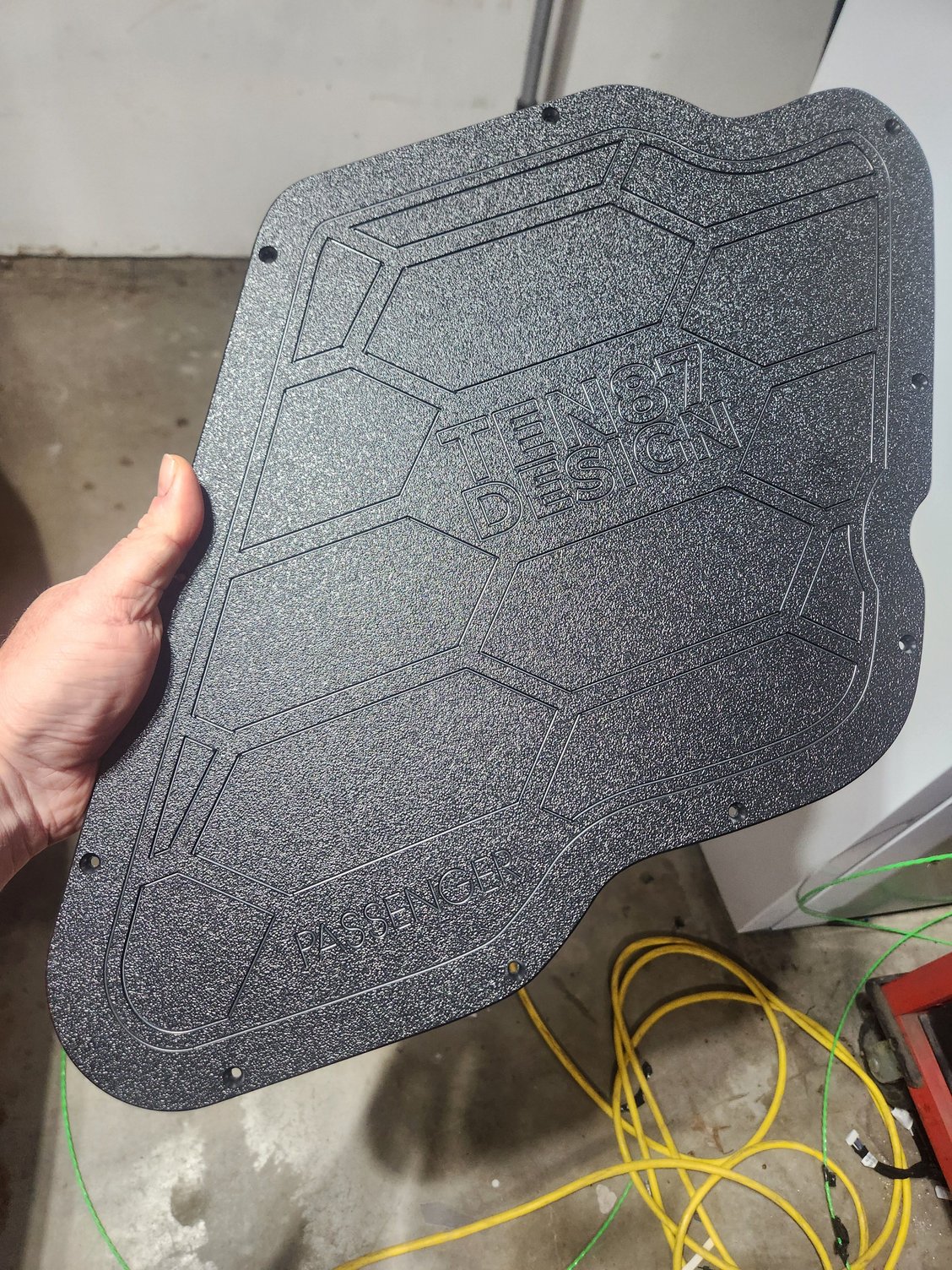

I'm using a fosgate p600x4 and it's much more than I need. Your lower door speakers are tricky. Most people pull those large speakers and replace them with 6.5" speakers. That results in a loss of midbass. You can add a sub in the rear, but sub bass is not a replacement for mid bass. I have focal isu200 8" components in the front and focal Icu130 in the rear. I didn't gain much by amplifying the rears and if I did it again I'd only get a 2 channel amp for the fronts. Curious what model kenwood you have though because when I had my kenwood ddx9907xr in my car it brought the bose system to life. I switched to an Android unit for a more "techy" experience and lost some of that sound quality as expected. Amplifying and upgrading speakers more than solved that problem. There is an audio store online that makes mounting brackets for the door speakers in various sizes so you can mount a larger speaker, but your choices are limited by the depth of the door. I also recommend installing the blockoff plates pictured for the doors to seal them up. Made a noticeable difference in the depth of music that these speakers produced. All in for everything except the radio I'm right at 1k spent.

Those block off plates are sick. I might have to get a set of those.
I thought they were worth it. I added a thin foam gasket to help seal them against the door. Not sure if that made a difference or not, but the addition of the plate itself definitely did.
https://soundsgoodstereo.com/product...0aAmpuEALw_wcB
Yeah, those are super cool. We used to cut up cheap trash cans and other moderately stuff stuff to deal doors..that's a great application of a 3d printed part though come to think of it, of you have a big enough printer.
