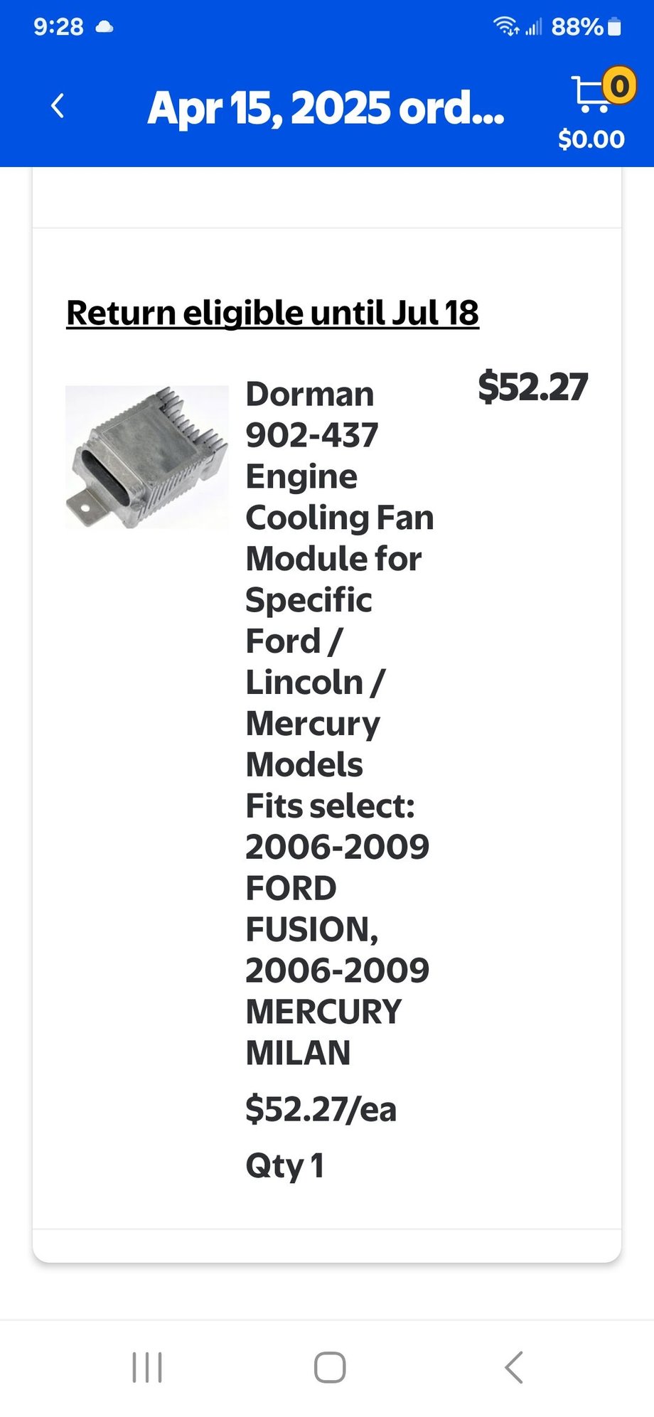

Interesting. I also found a ford fan module that fits our cars for 52 bucks shipped from Walmart. If you go to Dormans website it says it fits XLR and C6 vettes. Another cheap option

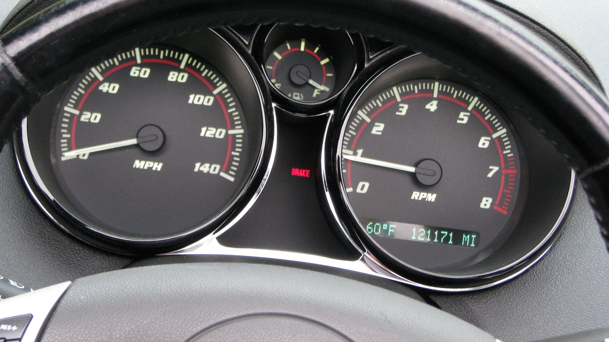

Back in late 2019, we bought a 2007 Saturn Sky that turned out to suffer from an improperly installed BCM. Not only was the mileage off by 110k miles, but the following did not work because a previous owner just plugged the new BCM in to get the car running.
NO brakelights
NO keyfob action for the doors, hence NO alarm (only the trunk release worked)
NO cruise control
There is NO WAY to REprogram a new/refurbished BCM that was plugged-in and powered up. You MUST then buy anbother refurbished one and have a certified mechanic with the right equipment to electronically install the BCM.
Back to our case, based on the Carfax which had service history, I estimated the odometer was off by less than 110,000 miles, so I instructed the mechanic to add that plus a little extra to what the odometer stated which was under 9,000. So I had him set the odometer to an exact 120,000 miles. This picture was taken 1171 miles later.
The properly installed BCM woke up the cruise control, resolved all key fob issues which also resolved the alarm, and the brake lights also worked. So IF you suspect an odometer rollback and the brake lights don't work, your suspicions could be factual.
