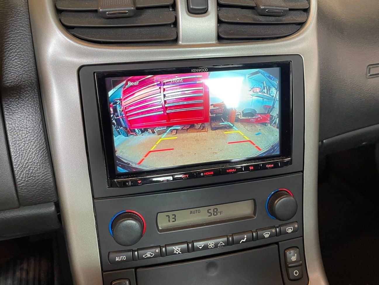

Well I ended up angling mine so the bottom edge of the bumper is just barely visible in the frame. It helps a ton when pulling up close to curbs or ramps. That way I’m not guessing if I’ve got 2 inches or a foot left

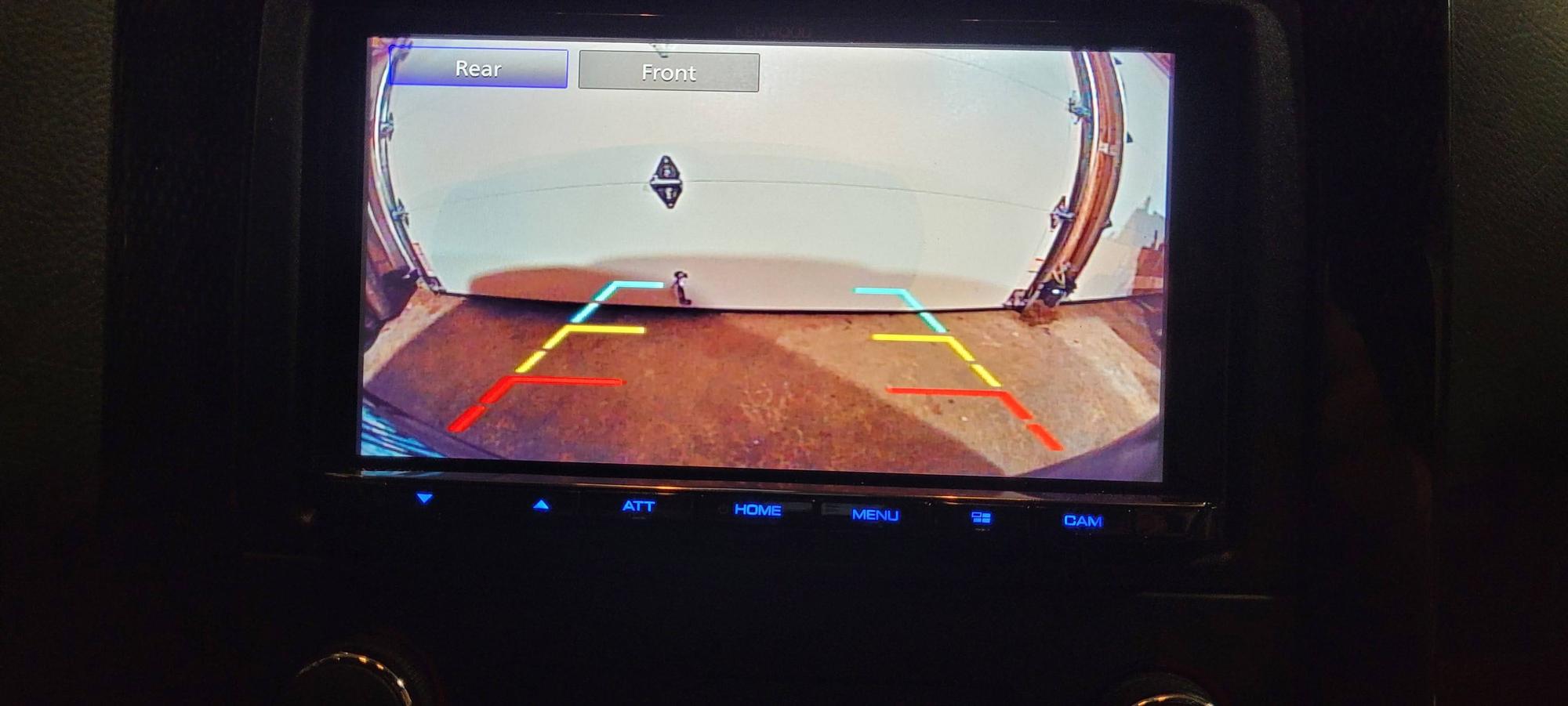

I just completed my front camera install (Natika off Amazon) and you had a choice of eliminating the red/yellow /green lines. I put a marker about 12 inches out from the tip of my bumper. This lined up with the red warning line on my camera so I chose to keep the warning lines.

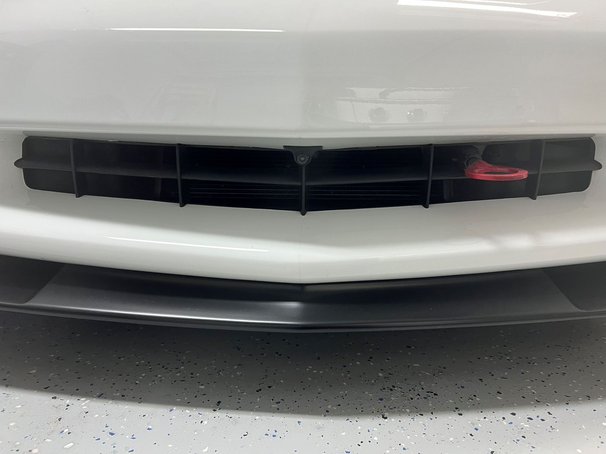

I installed a Boyo camera from Crutchfield as shown below. This gives the view of bottom edge of bumper, easy to see how close to anything.
Old Apr 24, 2025 | 06:00 PM
Pettrix's Avatar
Pettrix
Joined: Apr 2020
Posts: 1,779
Likes: 670
Looks good! Did you use double sided tape or mount it with screws?
How did you run the wiring from the camera to the inside of the car, back to the radio?
Old Apr 24, 2025 | 10:46 PM
Chukman's Avatar
Chukman
Joined: Oct 2020
Posts: 415
Likes: 247
From: Seattle, WA
I used double sided tape. It's been on about a year or more with no issues. I ran the cable up the passenger side along the wheel well and ran it along other cables already there. Then fished it through the large rubber seal/grommet that all the other wiring goes through behind the battery. It was pretty easy & blends right in. Mounted the same camera on the rear the same way. That cable comes through a grommet behind the right rear brake light, then under the rear carpet down to and under the center console to the radio.

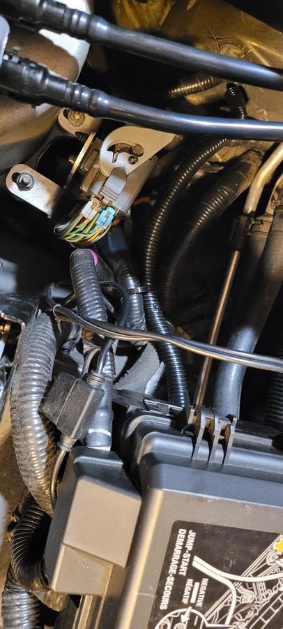

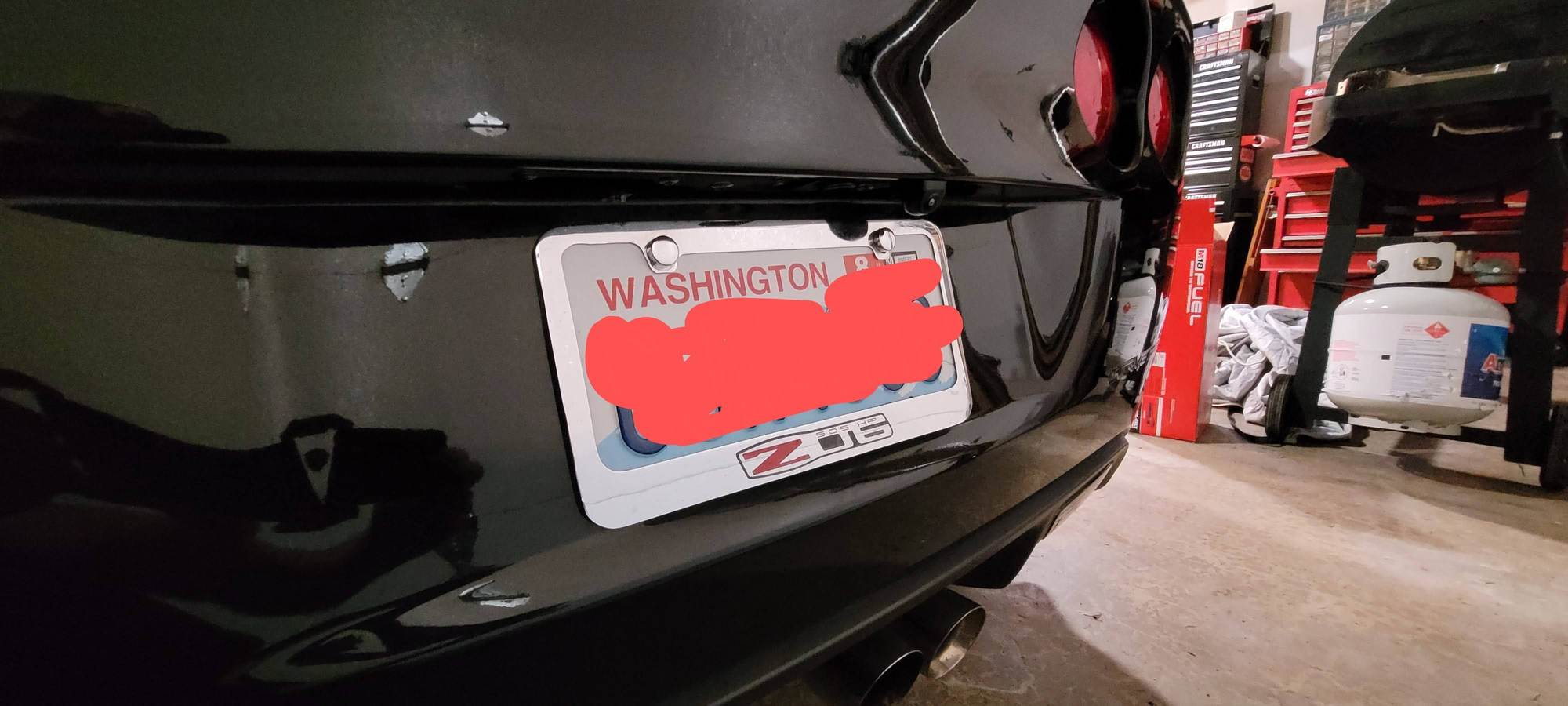

Here is my setup. Ran the wires through the grommet that the rest of the wires run through i the firewall.

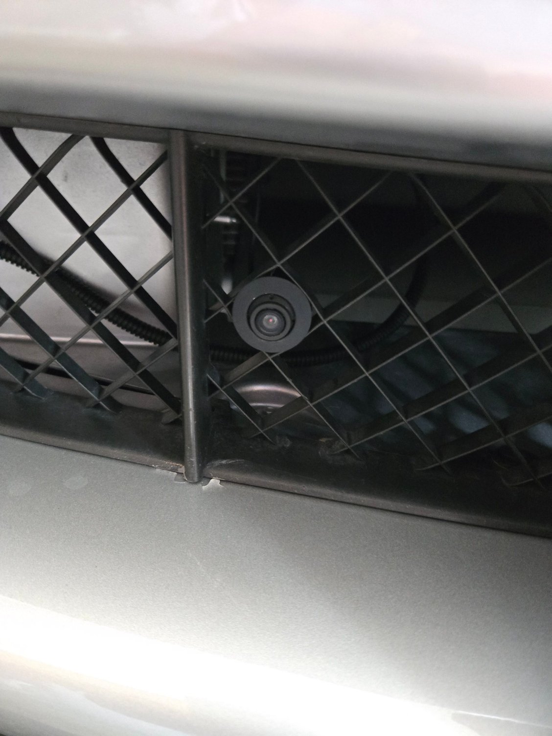

I put my boyo right in the grile diamonds fits like it was mad to go there.
