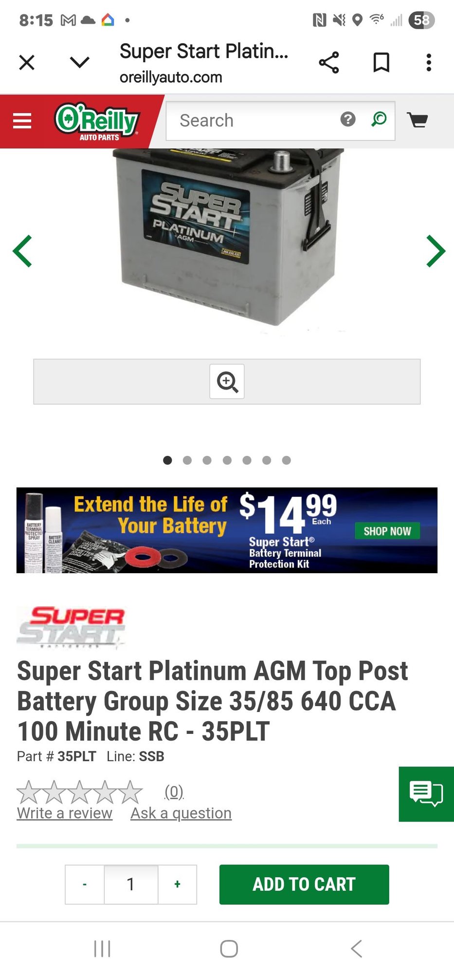

Side issue, but what Group number battery did you get? My 2008 has a Ford Motorcraft (yuck!) Group 96R battery in it.

I got this for my 2009 base
