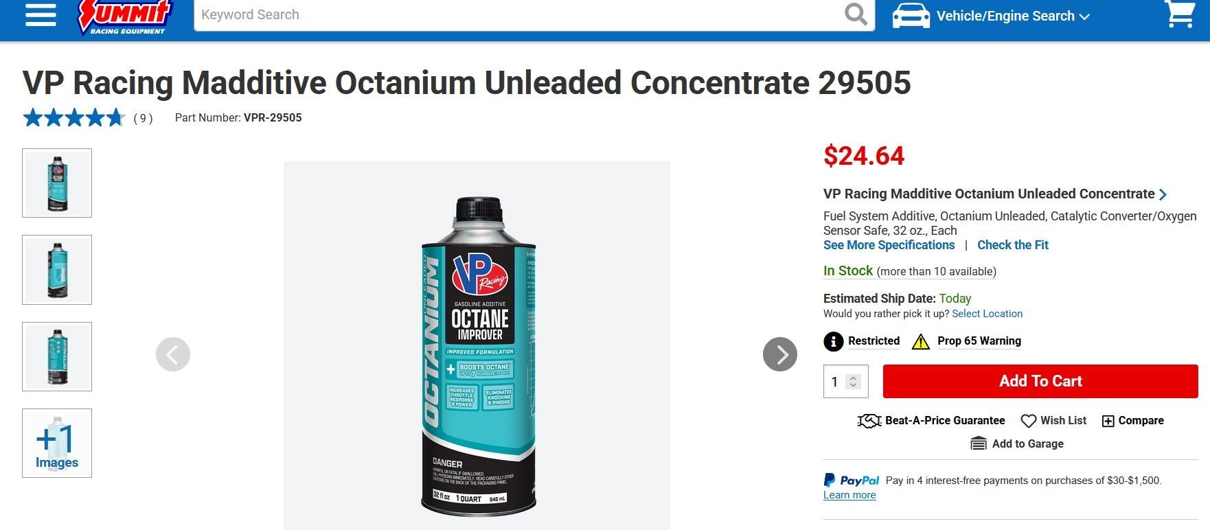

On a boosted application. Has anyone ever used this from VP Racing Fuels? They claim it's safe for 02s and Cats.
"If using Octanium Unleaded in vehicles with Emission Control Devices (ECD), dosage should be limited to 11 oz per 10 gallons of gasoline. Non-ECD vehicles can utilize up to 23 oz per 10 gallons of gasoline for long-term use or 32 oz per 10 gallons for short-term use but will require more frequent maintenance to prevent harmful damage or coating to engine parts."
