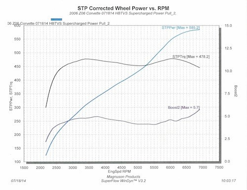

So the easy trick to really get the LS7 to pull hard to 7K gaining HP all the way to over come the problems on the restrictive flow intake manifold, is super charger making about 5lbs of pressure. Hence On the above dyno graft, put a ruler on the HP line from idle to 5.8K, then on that ruler line, continue the line to 7k, to really see what the motor can do when it can breath correctly all the way to red line. With long tube headers and high flow cats, 5lbs of boost, engine is making 650-700HP gaining HP all the way to red line, but the better one, is with the displacement of the motor and boost from say a TVS blower, the amount of torque that the motor makes just off idle to about 5Krpms, is freight train special that can break the tires any gear at will.
Maggie Heat beat super charger on stock LS7 with conservative tune, including stock exhaust manifolds and stock cam, and no meth kit to push the timing even more to gain eve more power, with it making about 650hp at the crank.
