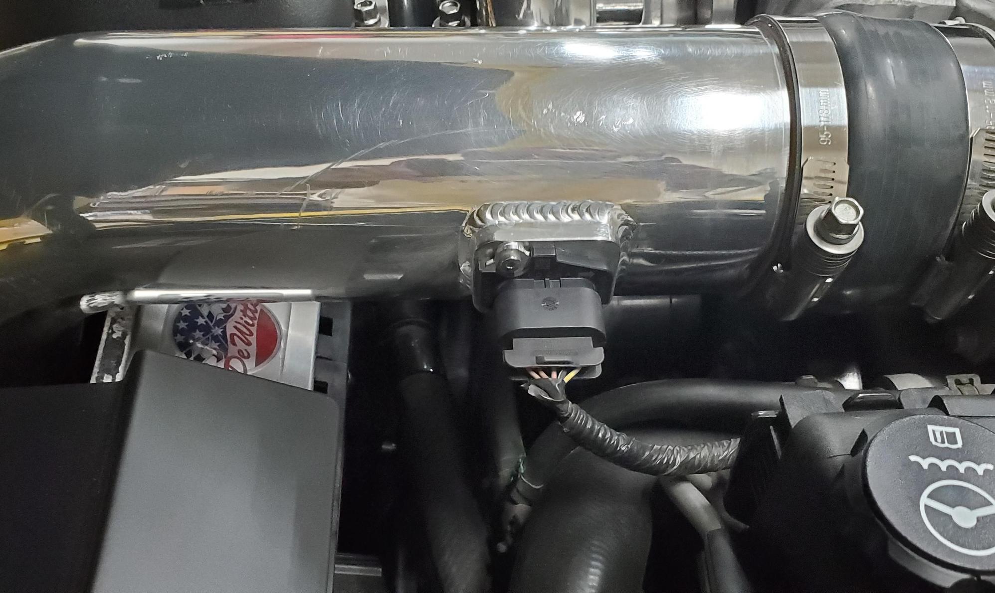

Your AIT sensor is part of the MAF sensor. and is already between the S/C and intake manifold (after the intercooler), so your going to spray the meth before the Maf sensor/after intercooler, so the IAT sensor can see the difference in the boosted air temp from the water spray..
As for tune, once you have meth kit in play, then it not just AFR, but the amount of timing you can advance without getting detonation problems to start with, then you get into afrs that are producing the higher amount of Torque and HP instead.
Okay, I will do the 50/50 mix. Not 100% meth.
Is that the AIT/MAF sensor in the picture? Where should I mount the Meth spray nozzle?
