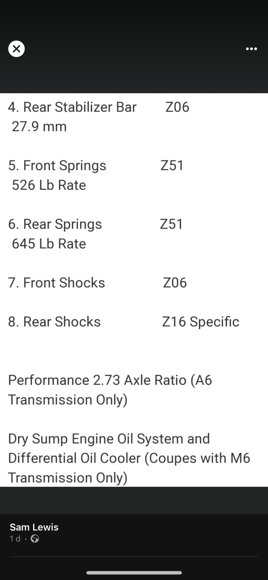

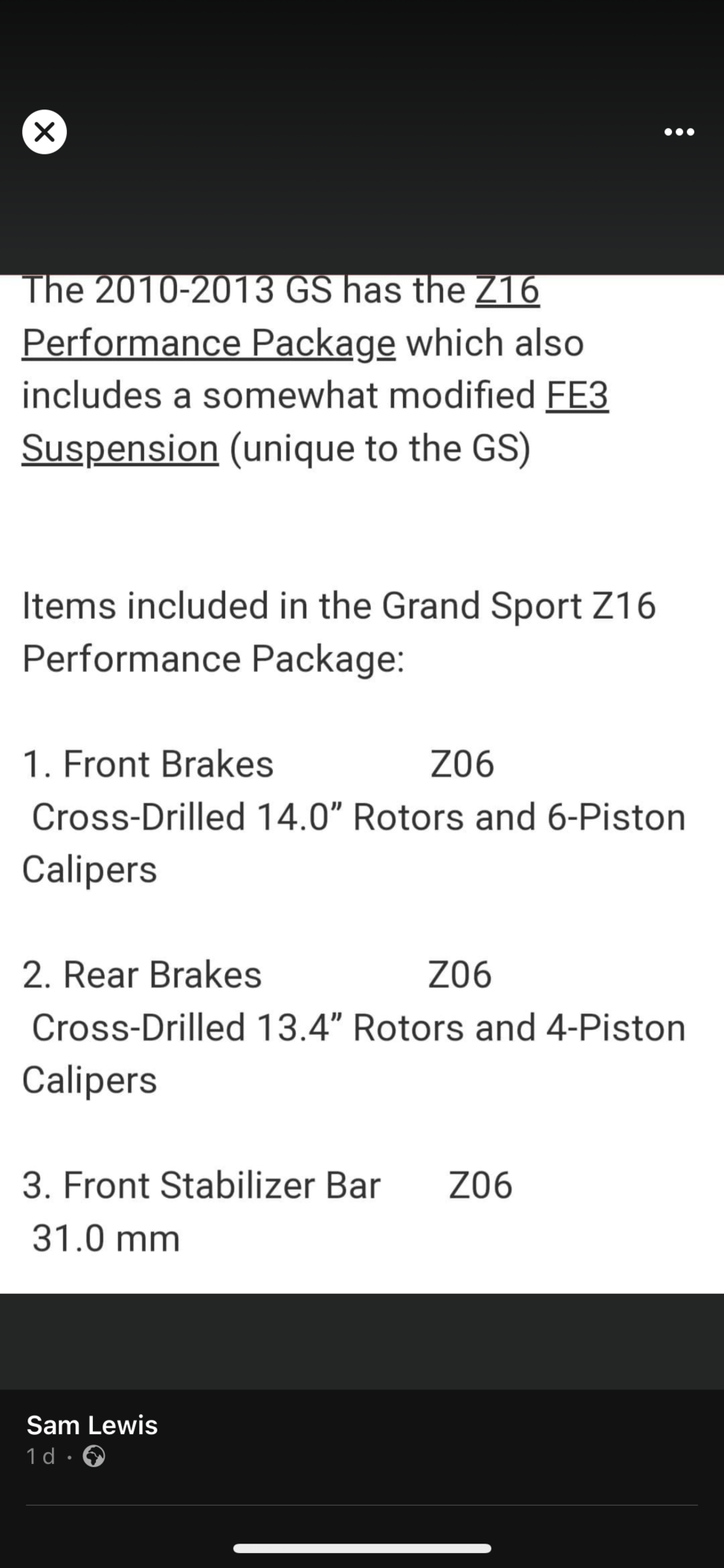

Old Jun 5, 2025 | 01:09 PM
MatsA's Avatar
MatsA
Joined: Jun 2016
Posts: 254
Likes: 67
From: Uppsala Uppland Sweden EC
2024 C6 of the Year Finalist - Modified
Originally Posted by jost6453
My son is considering the purchase of a ‘10
GS mn6. Car is perfect. Less than 10k miles. 4lt with dry sump, - std suspension. No mag ride.
The car rides very rough. I have an ‘11 GS with mag ride and it rides significantly better. A buddy has an ‘08 with std suspension. It rides decent as well.
Were there different suspension options in 2010? Different spring options? Different shock options?
Thx for any insight.
This is the suspension setup for a 2010 - 2013 GS
