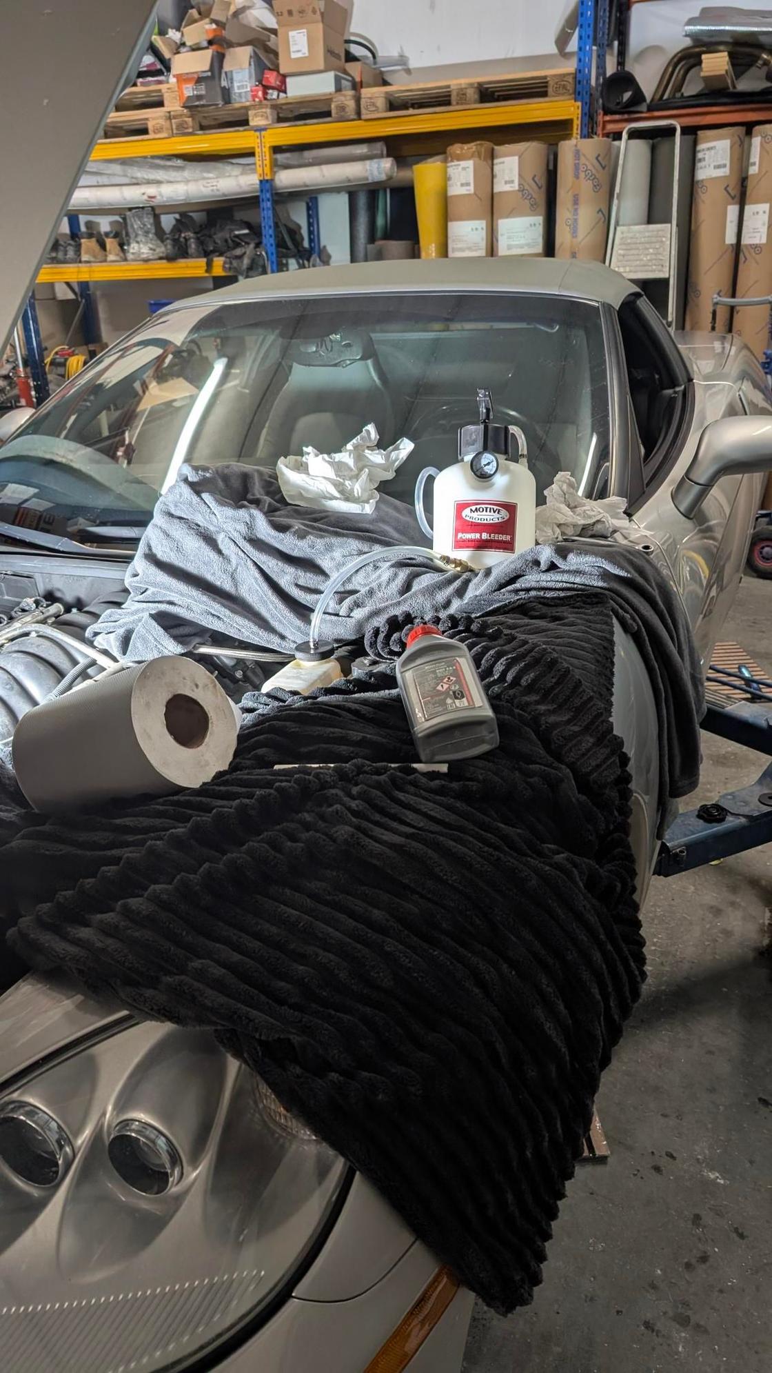

Bought the right pressure bleeder set, and used my Autel AP200 obd unit.
Its connected with my phone through the Autel app, and it bleeds the abs.(among lots of other neat futures)
In a sequence the app tells you what to do.
Keep the pressure bleeder at pressure, and make sure there is enough fluid nin the reservoir.
Easiest way is to have all 4 wheels off because the app let you do them all in one sequence,
Autel OBD2 at Amazon Autel OBD2 at Amazon
