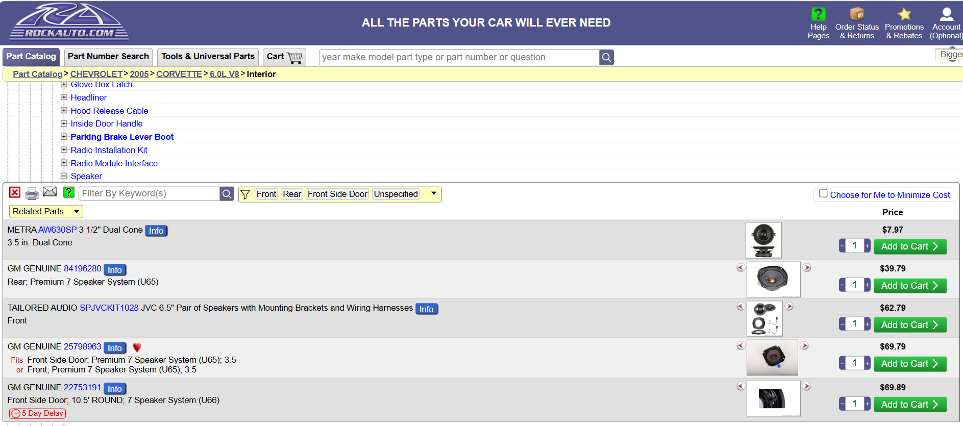

If you end up needing a speaker. I believe rockauto has what you need.
2005 CHEVROLET CORVETTE 6.0L V8 Speaker | RockAuto
I would not have thought about using Rockauto for speakers. Thanks for the tip!
