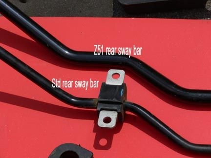

Years back I first installed new Z06 sway bars on my 06 base coup but didn’t like the way it rode and handled. Removed them and installed the Z51 sway bar package and was happy with the over all handling and ride. My vette has the F55 package and the Z51 sway bars improved the handling imo. I’d install the ones you bought and judge for yourself if you like the ride and handling. Easy to install them....
