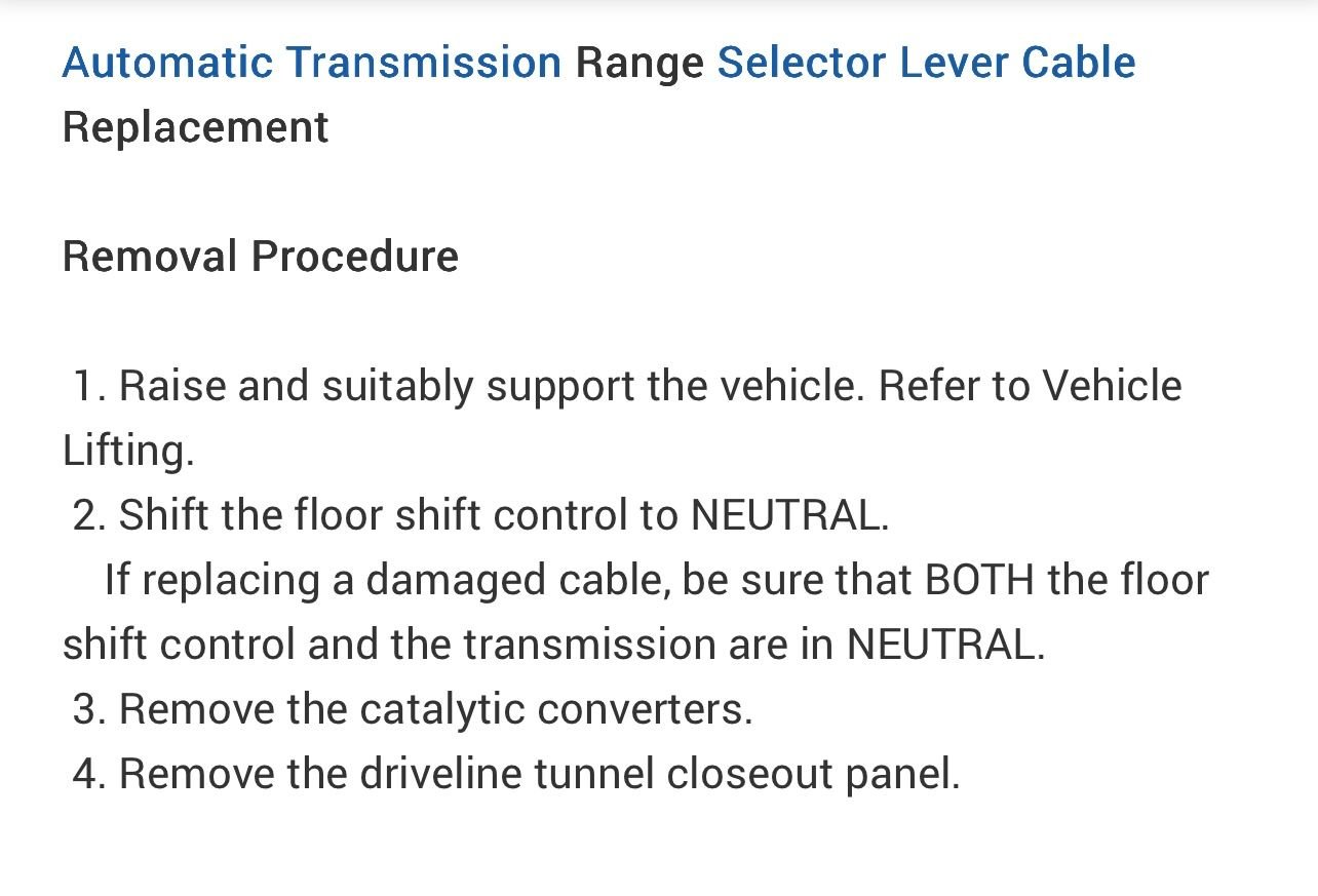

If the shop followed Service Information it says in step 3 remove the cats..I’d ask them if they did do this and make sure both clamps are tight on the passenger side cat and are not leaking…a leak will cause a P0420/0430 to set…that performance shop probably doesn’t know that.

Well if they did remove the cats it’s a “comeback” for them and are responsible that the car is right….it they can’t diagnose let THEM take the car to someone who can and they can pay for the repair and not you.
