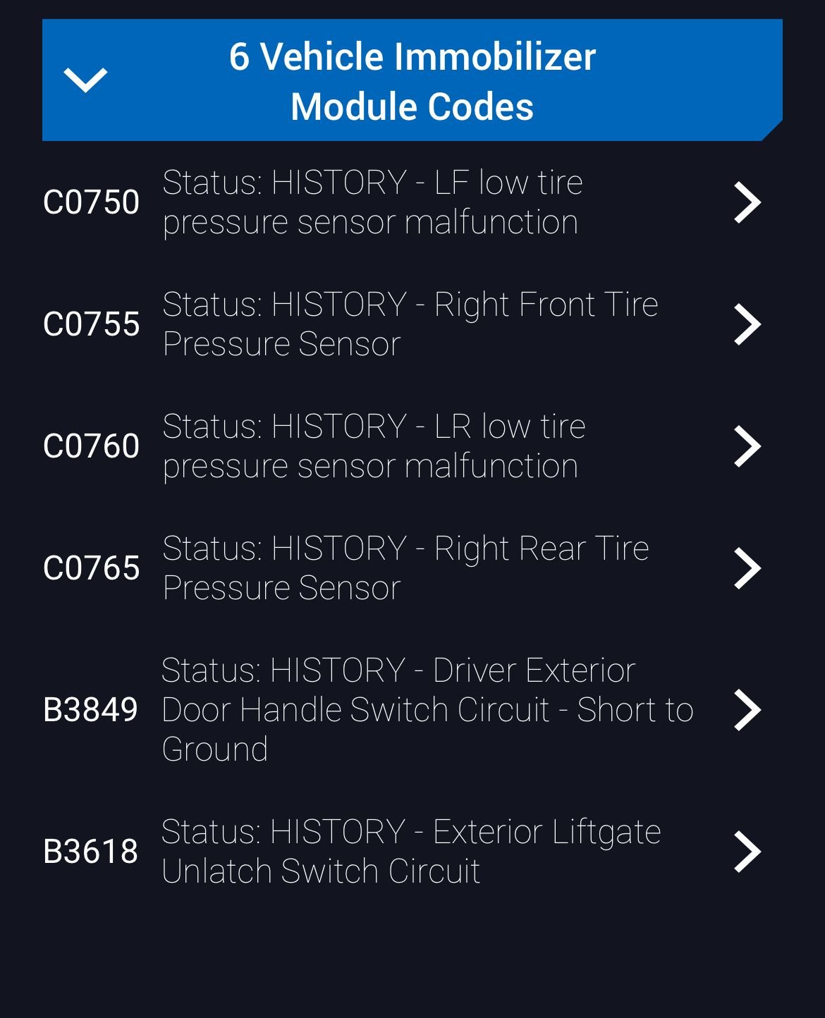

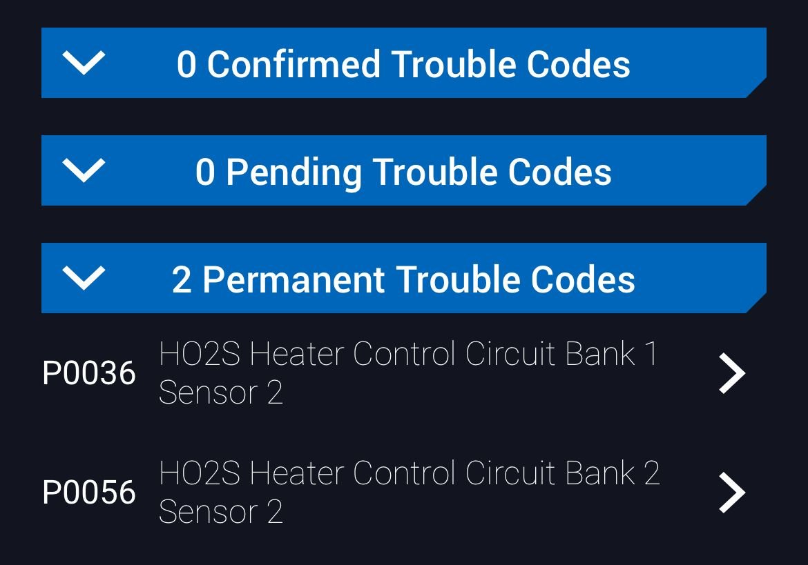

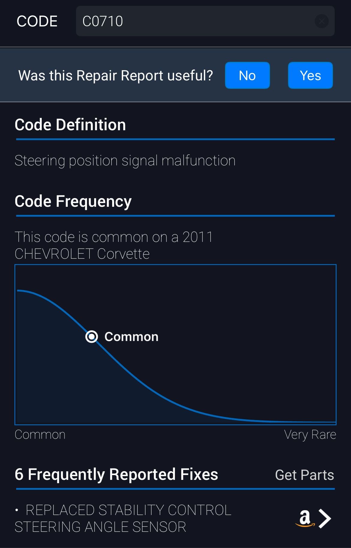

Hello,
Recently purchased a 2011 Grand Sport with 69k miles on it. Has been done up with a stage 3 cam, 8rib pulleys, headers, injectors, lifters, trays, springs and rods, upgraded transmission, etc. it was built to run.
Long story short, the car was in need of new tires and TPMS sensors. Was throwing service active handling codes, TPMS faults, etc. Needed a new horn relay because they said they couldn't get it to go into learn mode. Replaced the horn relay, then we were able to get the sensors calibrated and working with the car.
I get the new tires and TPMS installed and working, and as I pull out of the parking lot, get the dreaded active handling interference. Car literally put on the brakes. ABS also activated. Ran my Blue Driver code reader, got the steering wheel position sensor malfunction code, same as before the tire install.
I unplugged the steering wheel connector from under the dash so I could drive it home. It wasn’t interfering before the TPMS sensors, but now it is.
The battery terminals were loose, so I replaced those today, nice and tight. Cleaned some of the connectors and added dielectric grease. Cleaned all the battery side engine grounds as well.
Any advice/insights would be useful and appreciated. I got a good deal on the car for all the mods that have been done and I knew there would be some things I’d have to clean up. I talked to the tuner who most recently tuned it and he said everything looked fine to him and the car was running well when it left his shop.
Battery is also reading over 13V when the car is off.
Photos of the codes below for reference.

Dielectric grease and zip tie did not fix the active handling issue. I’ll run with it unplugged for now. Will try to find someone with a tool so I can either recalibrate or see if it just isn’t working at all.

I bought bi-directional scan tool. Within 5mins, I identified that the steering wheel position sensor was 360* instead of 0*. So whenever the prior owner installed his camshaft, he must’ve screwed up the re-install.
I reset it, took it for a drive around the neighborhoods and no “Service Active Handling” light came on!!!! Here’s to hoping that’s all it was! Erased all the other historical codes and re-scanned. Came back all clear!
