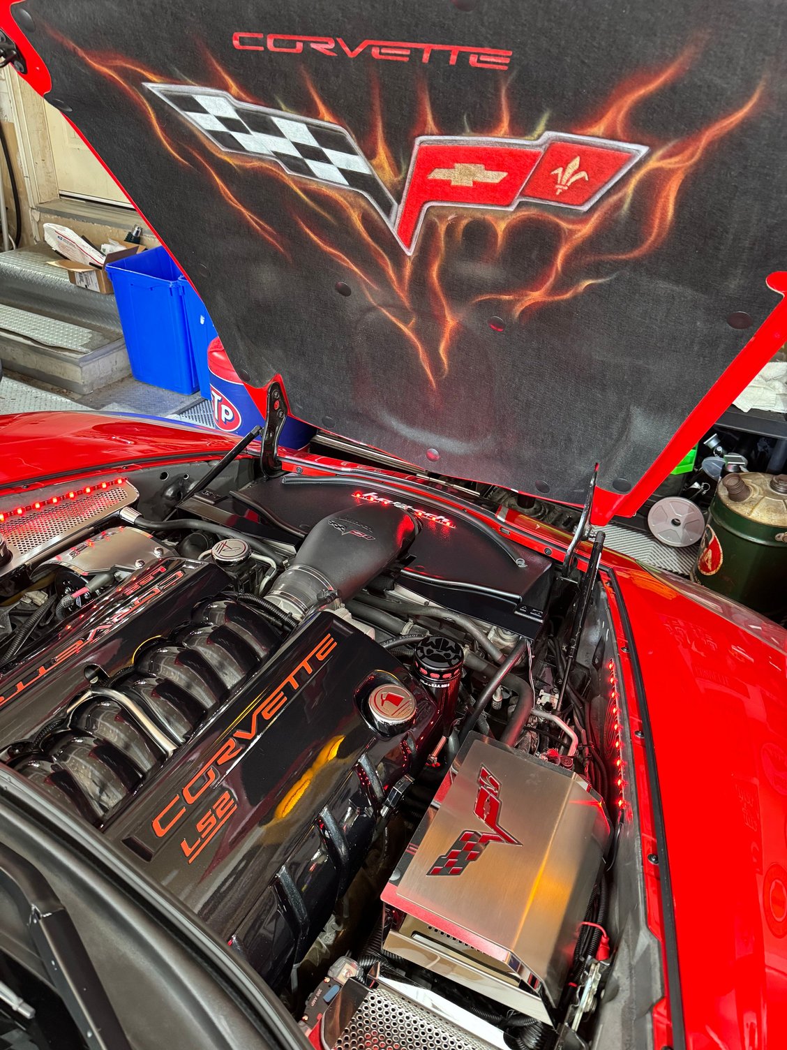

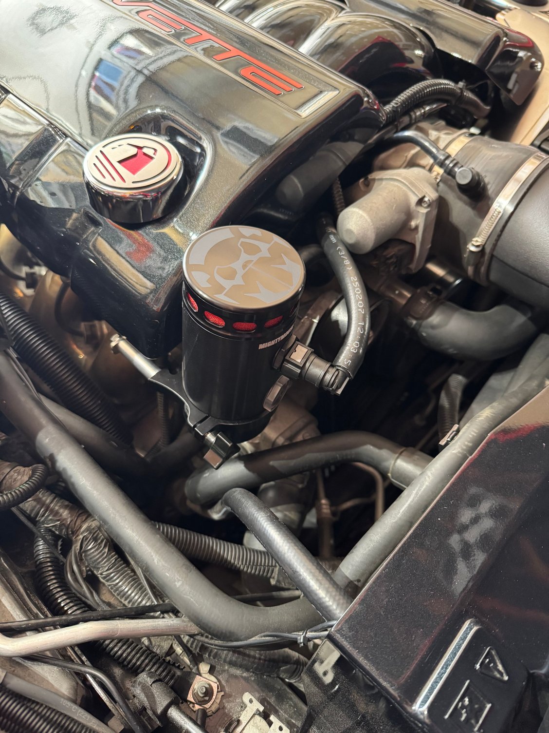

Thought I’d share some pics of my Mighty Mouse Mild Gen 6 Catch Can install on my 2007 Vert.
Working with @David@MMS was amazing. He made sure I had everything I needed and answered all my questions.
The fitment was sensational, and the installation was a breeze.
I looked at several different options before I decided to go ahead with MM, and I’m extremely happy with the final outcome.

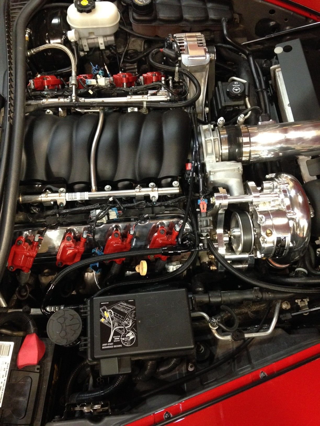

I did a Mighty Mouse Catch Can when I did my SC build. Catch Can fit in nicely between the battery and the fuse box.
MM is a superior product when I compared it to all the others.

Did Mighty Mouse provide that bracket? It looks different than normal head mount one I have.
Old Aug 5, 2025 | 02:40 PM
jeffsolomon's Avatar
jeffsolomon
Joined: Feb 2018
Posts: 149
Likes: 68
From: Newmarket Ontario
Yes, when communicating with Dave @ MM, he told me about the bracket which is part of the newest Gen 6 Catch Can. He also suggested I mention to include the spacers (no additional charge) on my order so that I could clear the fuel rail covers. The fit of everything was perfect.
