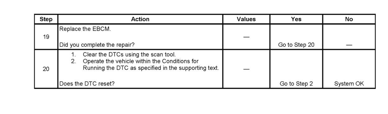

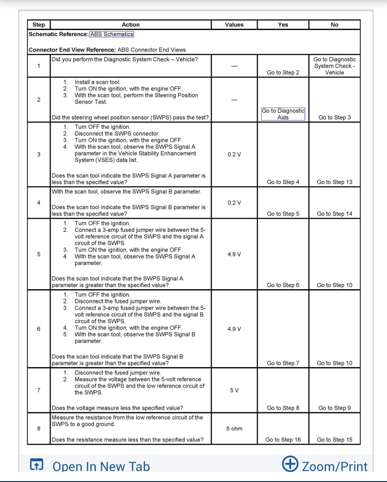

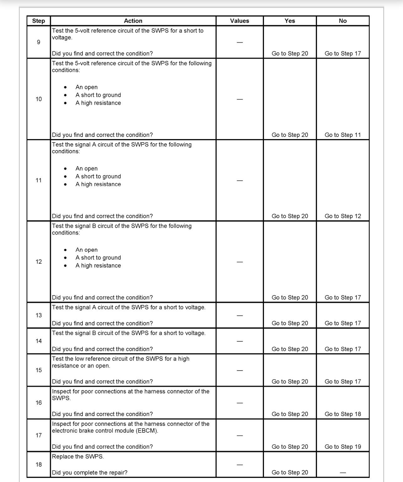

Unfortunately, we can't diagnose this for you but if you have either a factory level or equivalent aftermarket scan tool and have some technical ability you can follow the factory flowchart below...if not I would seek out an automotive electrical specialist....you should be OK in driving it this way…most shops will just go to steps 18 and 19 !!

Test Description
The numbers below refer to the step numbers on the diagnostic table.
2. Perform the Steering Position Sensor Test in order to verify if the steering wheel position sensor (SWPS) is operating properly.
3. Tests for the proper operation of the steering wheel position signal A circuit in the low voltage range.
4. Tests for the proper operation of the steering wheel position signal B circuit in the low voltage range.
5. Tests for the proper operation of the steering wheel position signal A circuit in the high voltage range. If the fuse in the jumper opens when you perform this test, the signal circuit is shorted to ground.
6. Tests for the proper operation of the steering wheel position signal B circuit in the high voltage range. If the fuse in the jumper opens when you perform this test, the signal circuit is shorted to ground.
7. Tests for a short to voltage in the 5-volt reference circuit.
8. Tests for a high resistance or an open in the low reference circuit.

There is a better than a good chance that its the connector for the SWPS under the steering wheel. I had the same alarm, and it was a TSB back in the day. I've attached the TSB so you can check that out before digging deeper. By undoing the connector, cleaning the pins, reconneting and zip tieing the connector solved my issue. It is fretting caused by the telescopic steering wheel stretching the connector.
