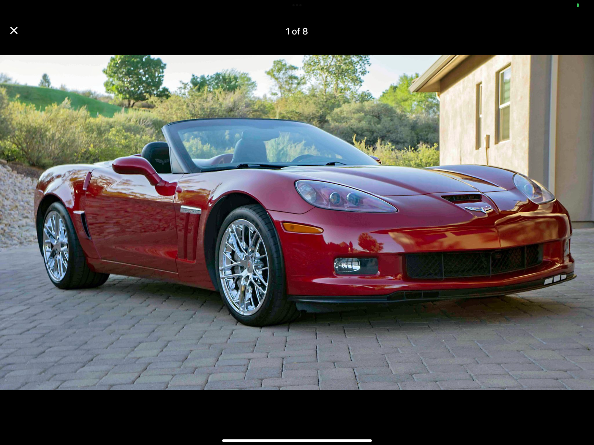

Welcome Back, Its been a while since you were here. You must have forgotten about the PICTURES!! LOl

Great pic(k)! I think my jaw dropped when the image loaded...

A great picture of a truly beautiful Corvette!

NICE CAR!! Thanks for the pic!! Make sure you put some miles on it!!
