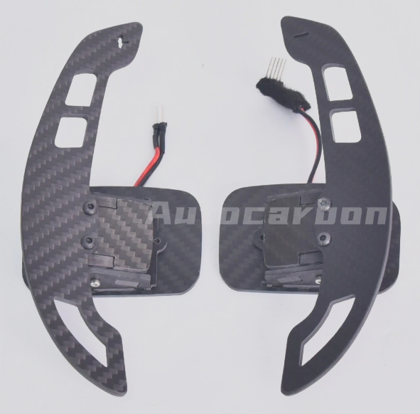

Looking on Ebay, I found these. Don't know anything about them. I would prefer to keep the stock shifters, if possible.
See the link

Take it off you may have to shave off just a bit of plastic, sometimes plastic pieces will bind

Does the car sit in the sun/heat? The plastic parts can expand and bind. The factory put grease on the metal pins where it goes into the plastic part. The grease can harden over time. Pulling them apart and greasing them with synthetic can unbind them.
Honestly, doing the F1 mod is best if you are going to pull them apart. The OEM version is outdated with the positive on both sides to push. All C7s and C8's use the right side as upshift and left side as downshift.

No, the vehicle is garage-kept. The issue is only on the left-hand paddle. I performed the mod on the right-hand paddle a couple of years ago. I intend to pull the defective left-hand paddle to see what is going on with it.
