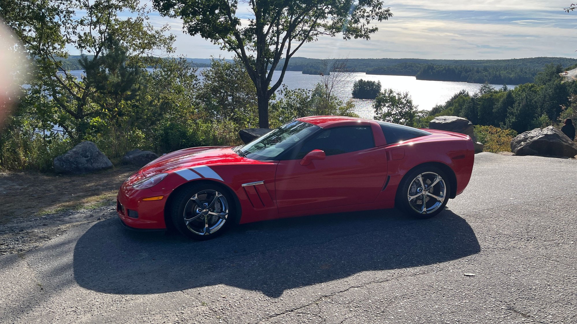

Yes, I’m a CCO member, so I’ll likely be at next Wednesday’s meeting, although they haven’t announced where. If the weather is OK I’ll drive the Vette. I’ll ask the membership director if you’re there and then find you. Here’s my ride. There isn’t another one exactly like it in the club.

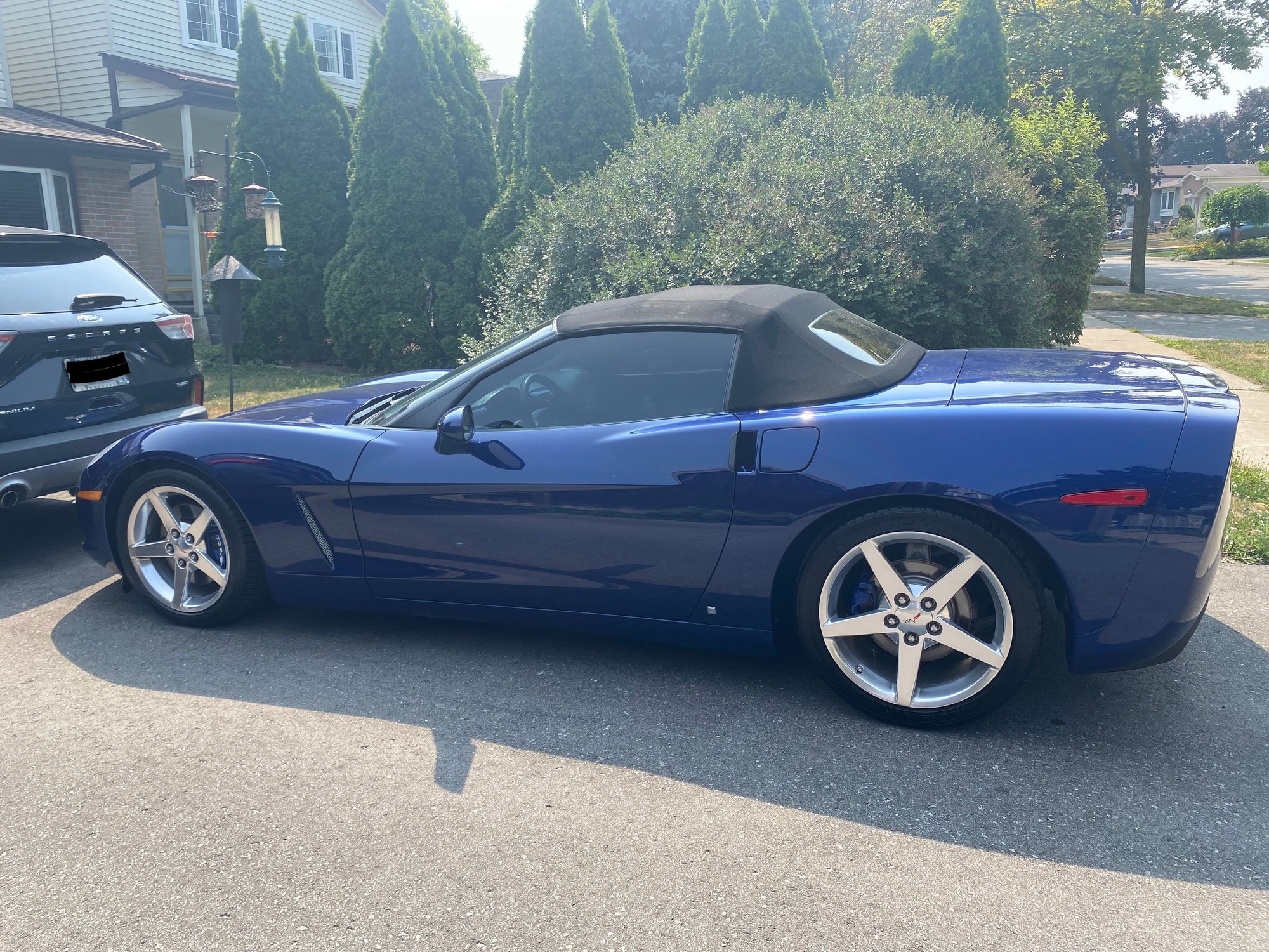

Gorgeous car! I'm planning on being at the meeting as well. I'll also be at the Trivia night. Here's my car. I'll be the one with the blue/purple map lights. LOL! I'll also be one of the few women in the room.
