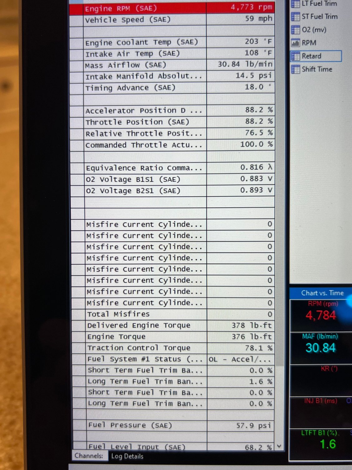

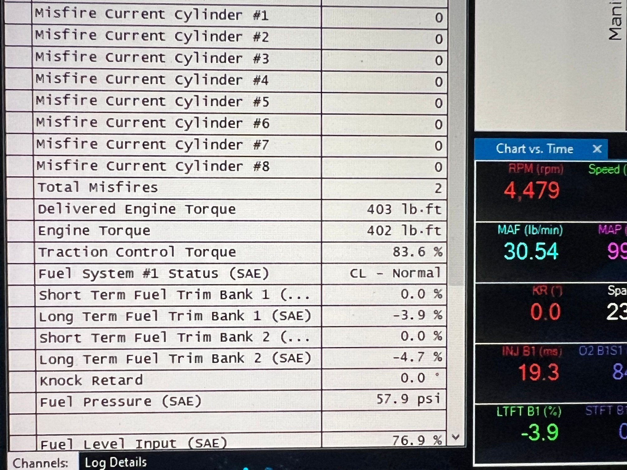

According to hp tuners I’ve picked up some nice gains down low… before est tq and after e85. I’ve read to copy the mbt spark table over to the high octane table when running e85 since it is possible to reach mbt on 100 plus octane ethanol . Can anyone confirm this?
93 pump est tq
93 pump est tq
Ethanol est tq
Ethanol est tq
