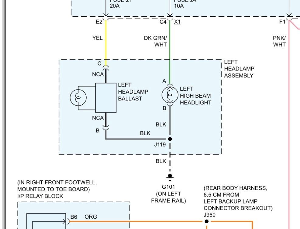

Hi all, I'm working on my cousins 07 base model with HID lights. He's complained for years about poor low beam Illumination. When I say poor, I'm suggesting about 60% brightness. He claims it's been like this for years and keeps bringing up the recall (that its never been in for... for several reasons). When I read on the recall, it mentions no low beams or intermittent. His always work, so I figure not the recall issue. With it being years like this and both sides (unaware if both sides started at the same time), figure the bulbs and ballasts if failing wouldn't last years without total failure. So I want to start with the basics and interested in learning where the grounds, relays and fuses are for the headlights. Thinking grounds... the high beams and signals are fine, and thinking they'd have a common ground??
Also, to reinforce starting with the basics (grounds), his car has been driven over 200k miles include full time through Canadian winters. I know! 🤦
Thanks for your help.

Thanks for the replies. I forgot to mention that I replaced a dead bulb last year with an Osram and there was no improvement.
Do either of you know where the lighting grounds are?
