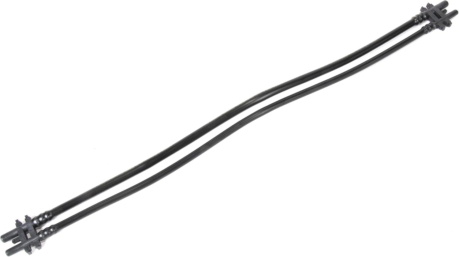

Is this the crossover tube with lines?
Yes, a new tube includes the feed line....you can (or at least you could in the past) get the inside feed line separately. The corrugated stainless tube gets stiff over time, so is recommeded to replace the whole pipe for ease of reinstallation.
Wait until you look up the 4 orings to replace on the pipe.....150 bucks and don't come with a new crossover.
