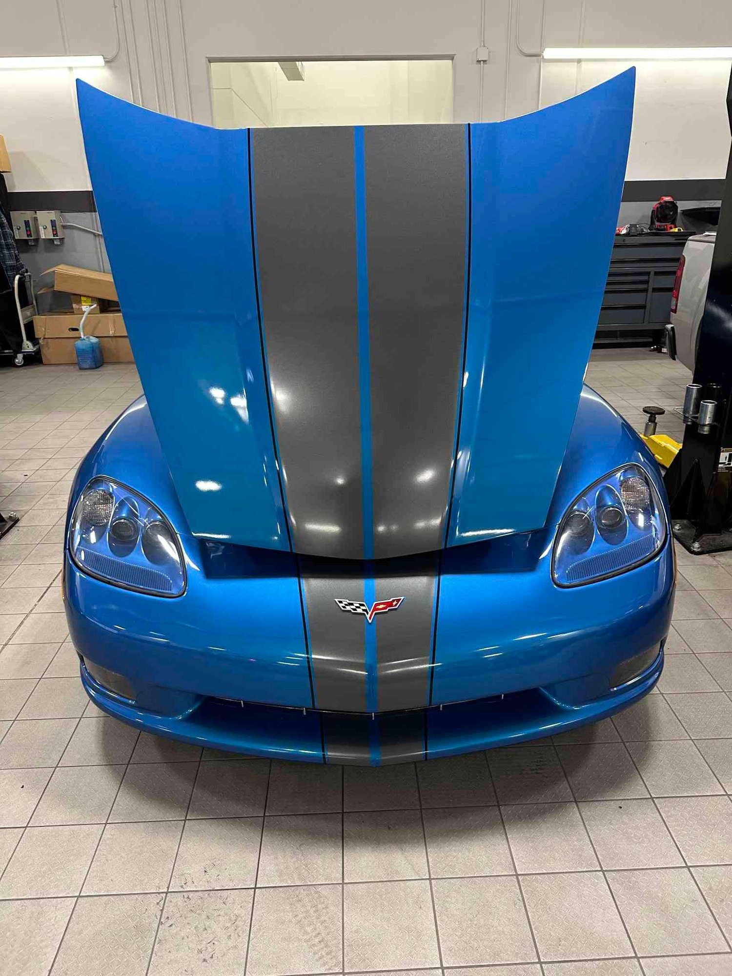

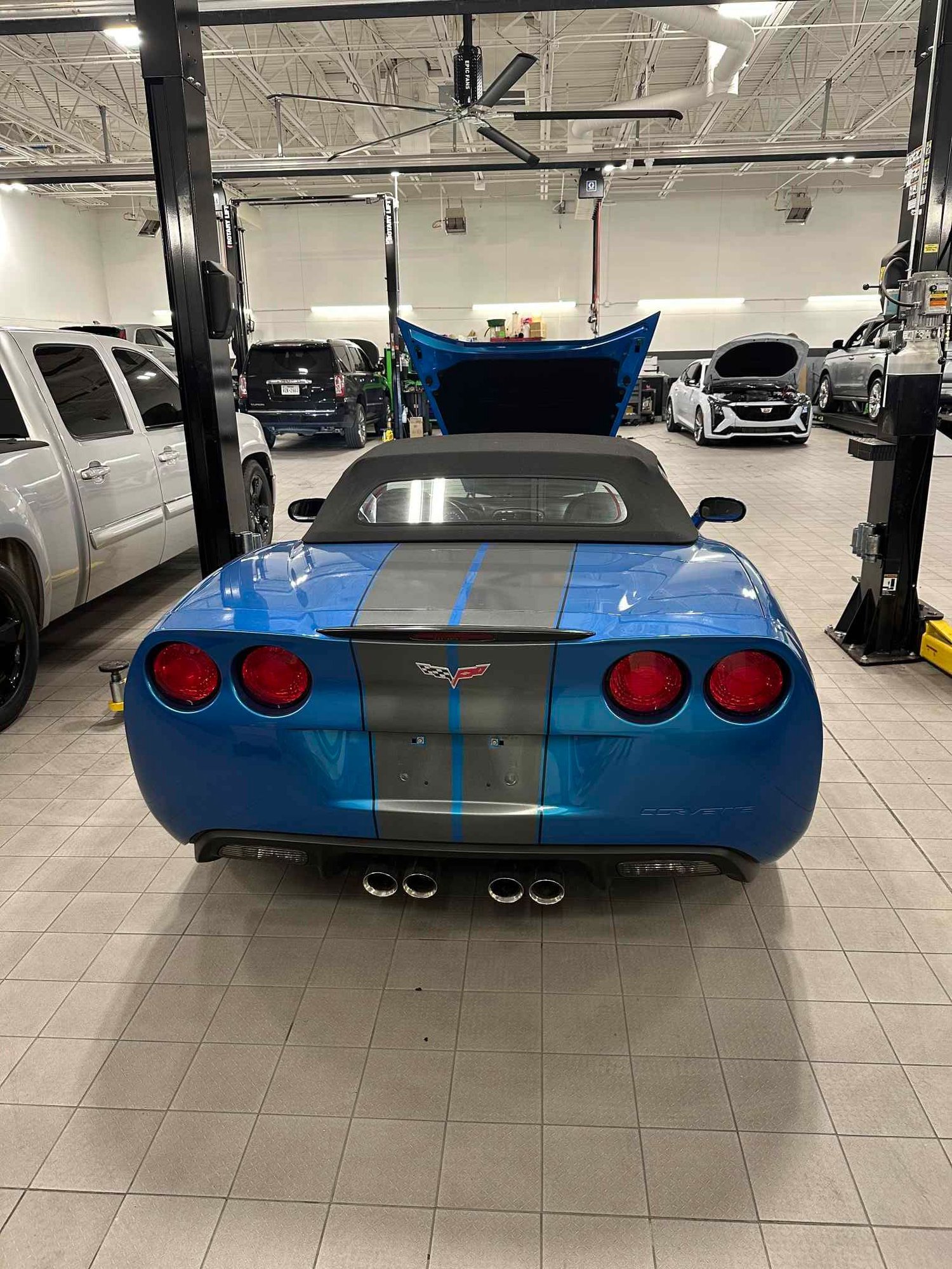

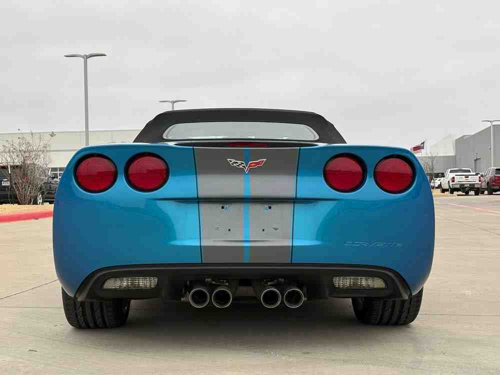

Can wrap be removed without damage to paint? Thoughts/considerations? No idea on when it was added.
