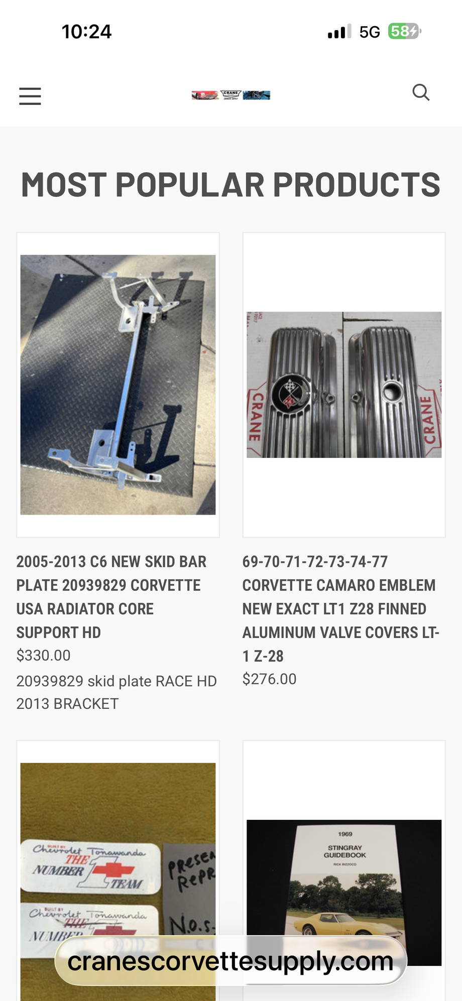

Cranes Corvettes makes a stout radiator support for $330.

Posts: 1,775
Likes: 669
As the saying goes, you get what you pay for. The Ebay ones are Chinese made. I would opt for the billet USA made
https://cranescorvettesupply.com/200...re-support-hd/

If the lower rad support is too strongly constructed, then if it gets hit hard enough something else is going to give way. There’s a sense that the OEM support was made to be sacrificial so that it breaks before something more expensive does. Just my .02. They may sometimes call it a skidplate but it’s anything but.

Agree with FW. Nothing wrong with the eBay/Amazon cheapies. Shouldn't pay more than $90.
Put THIS ONE on 5 years ago. 83 bucks. Don't think you need a $350 one unless you just really like ramming into things.
3 tips:
1) make sure to get the one-piece unit and not the two-piece with all the bolts.
2) make sure new one includes the insert rivnuts already installed.
3) for asthetics, a little black paint keeps them from standing out too much.
