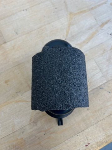

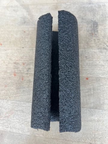

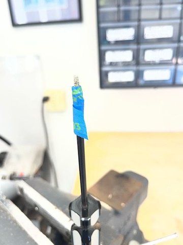

Just finished the install of the Vette Lights LED bulbs. The high and low beams look strong during the day and I'm sure they will be great at night. I picked up some "tricks" during the installation so I thought I'd share.
1. Although some have successfully changed bulbs without pulling a wheel I couldn't have done it even though I have a lift. I'd suggest you pull a wheel unless you have the arms of a chimpanzee.
2. The long rubber dust covers (high beam on the inner side) are difficult to seat as they have aged and become inflexible. I used split foam pipe insulation in the final installation to make sure the high beam covers stayed put. The split foam "bulks up" the back of the high beam covers. This added bulk keeps the covers installed permanently or until another bulb replacement is required. The high beam covers stay positioned because the fender liner access port "lid" held in place by plastic fasteners, presses against the foam during and after final installation, The other dust covers on the outside (low beam) stay in place and don't need added bulk. Note: Vette Lights furnished replacement high beam covers but I preferred to use the stock ones because they fit better.
3, Working with the tiny ten mm torque screws is tricky because if you drop one it is probably gone forever. I held a small extendable magnet below each screw as I took it out and caught it. To install, I used a 10mm nut driver with the 10 mm screw taped to it. Keep in mind it's very easy to drop and lose the screws without "tricks."
Split foam
Split foam
Split foam over bulb cover
Nut driver with 10mm screw taped
High beam dust cover

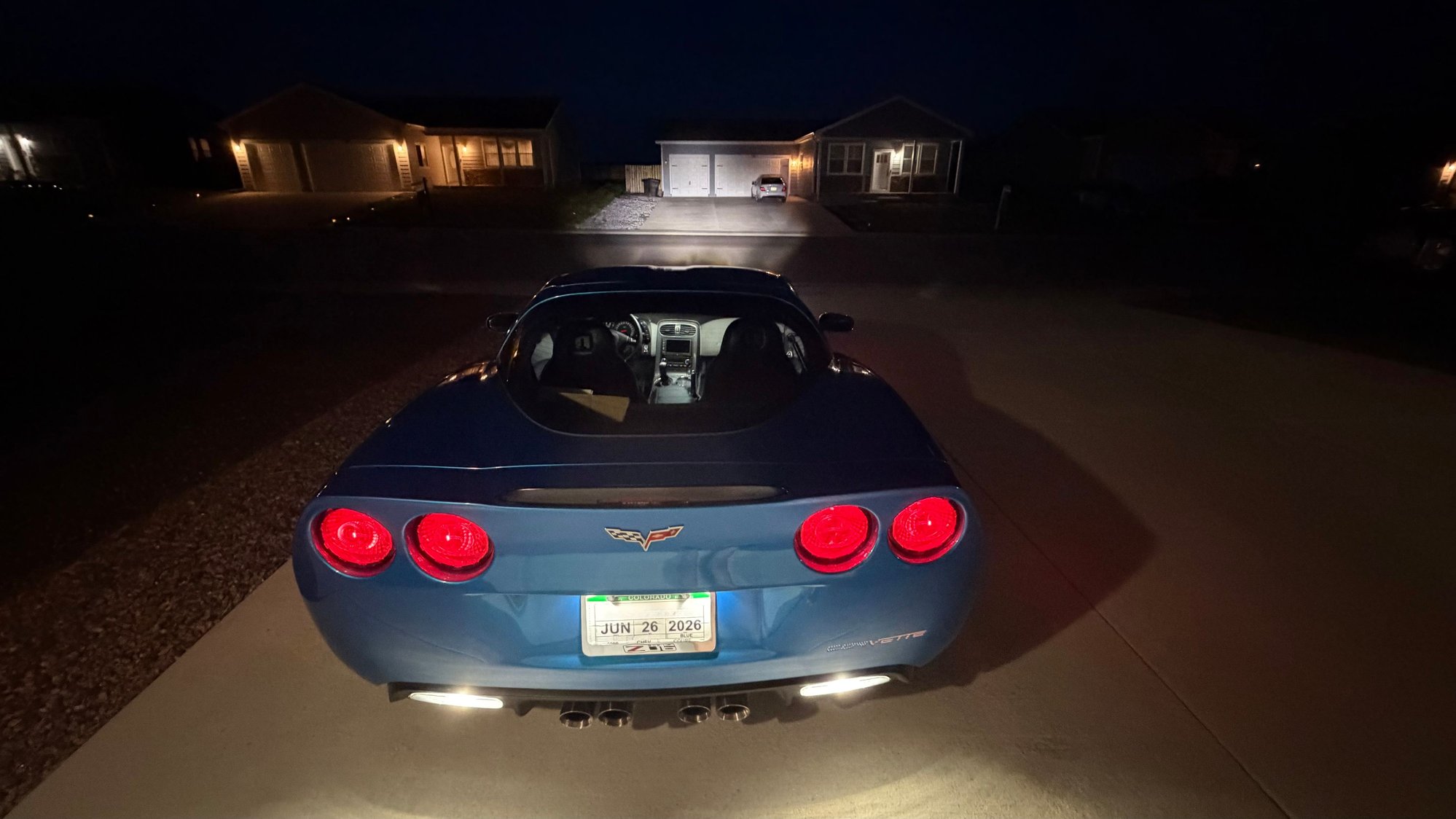

I got my LED's installed. Now I'm waiting for dark to take it for a quick test drive.
Initial views are they are very bright! I had zero messages on my gauges in the message center. All the bulbs work properly. Highs, lows and fog lights. I didn't need any resistors or anything else. Just plug and play.

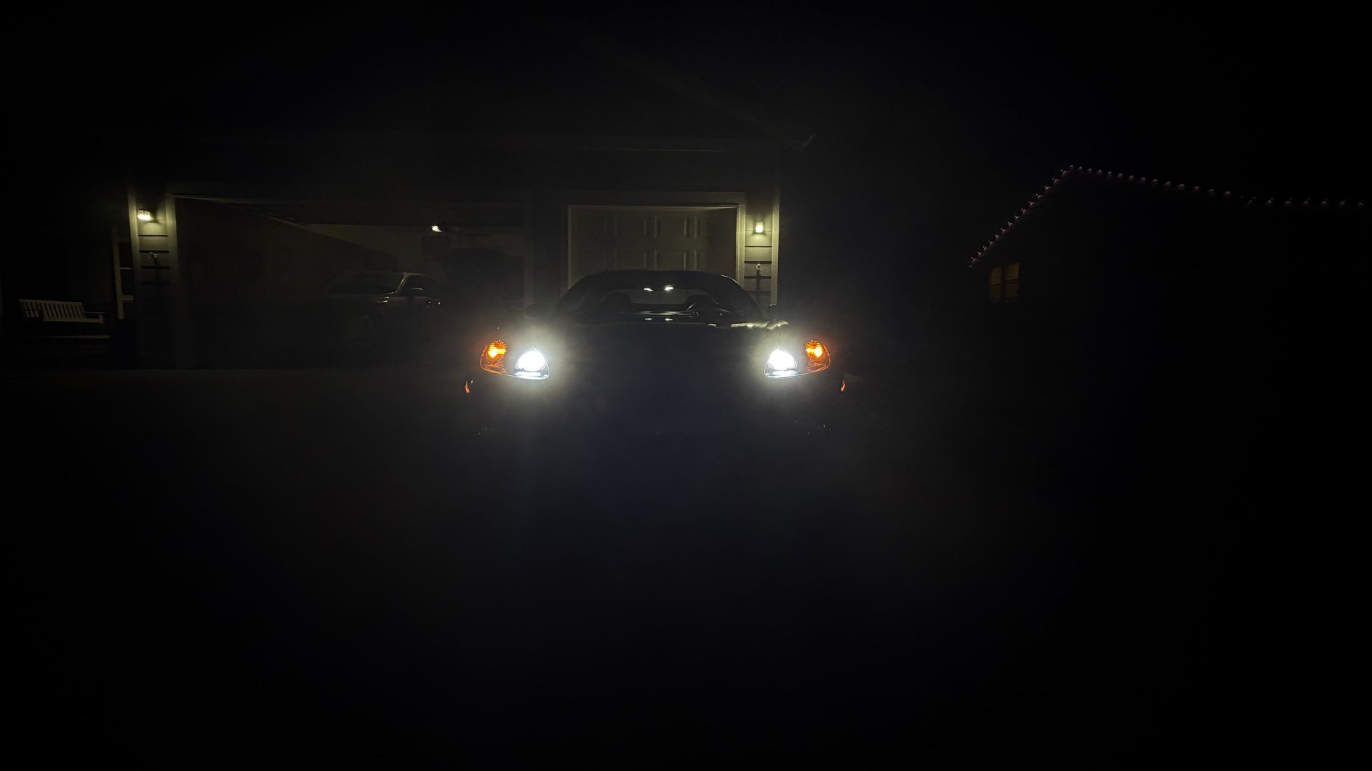

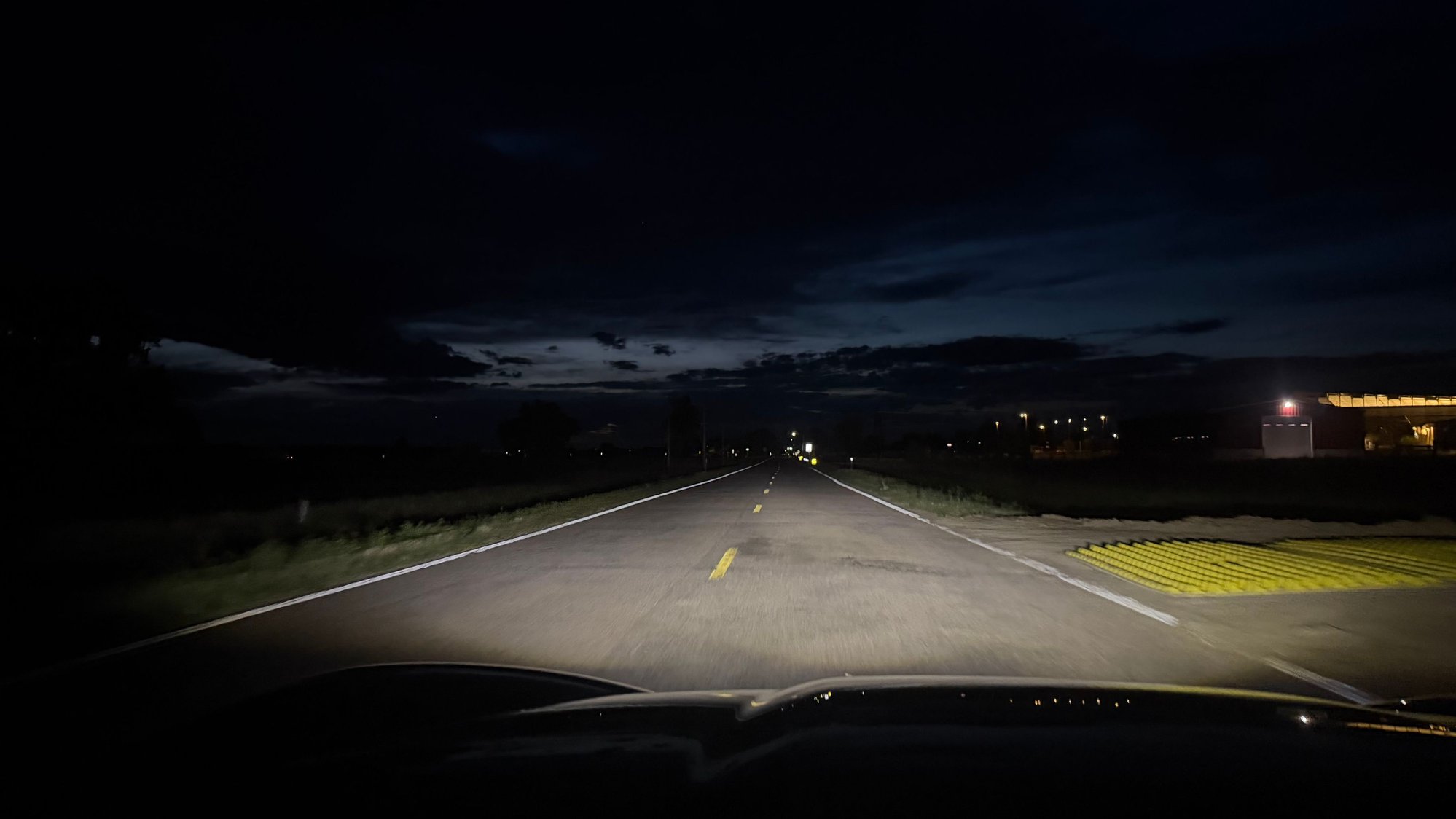

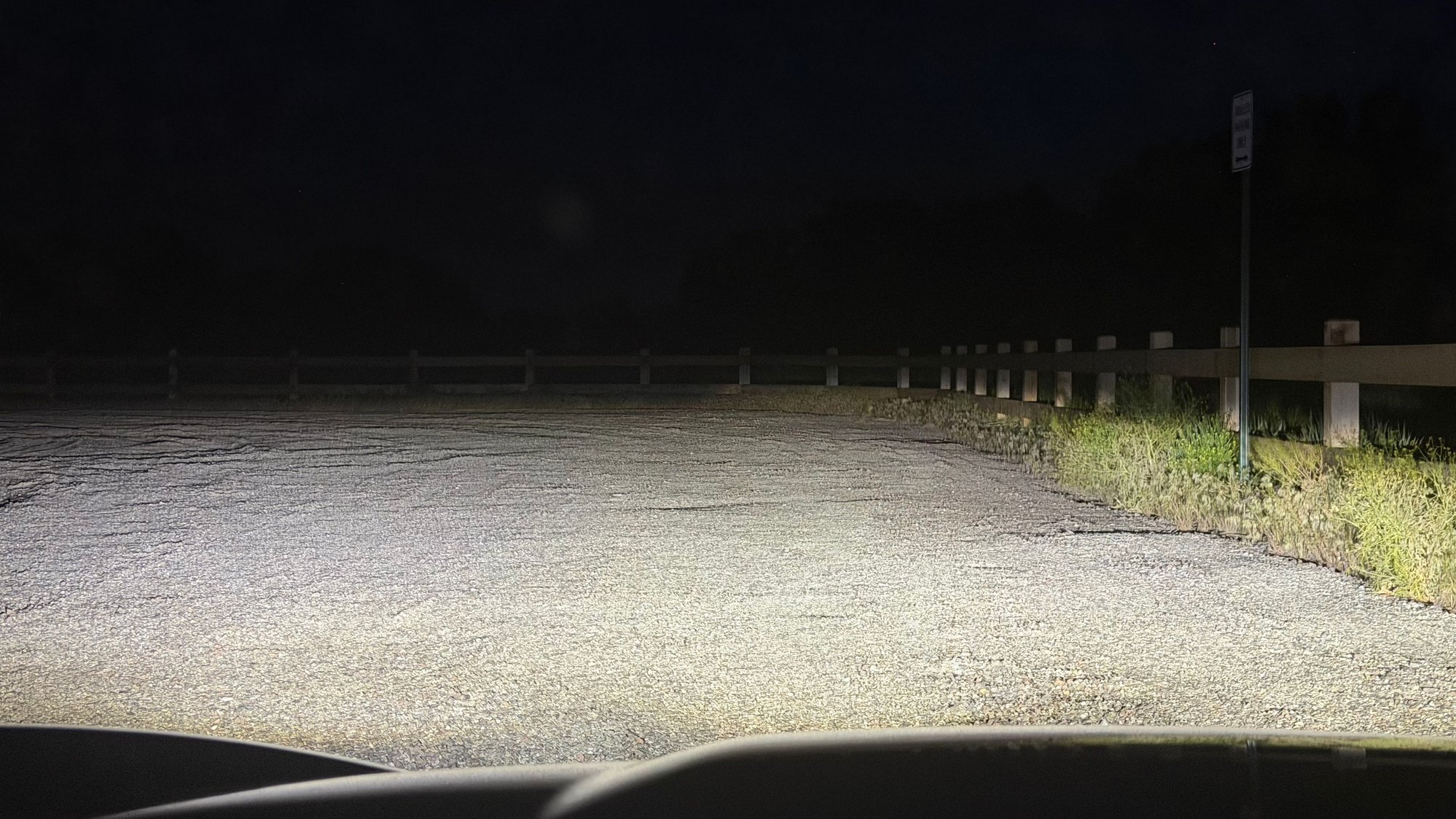

Holy moses these are like daylight! Wow! The difference is insane. I had trouble seeing the road coming back from Portland in March. No issues now whatsoever.
These are Auxito 6500K LED high beam, low beams and fog lights.
I'm not sure the neighbor will appreciate these when I leave at night.
