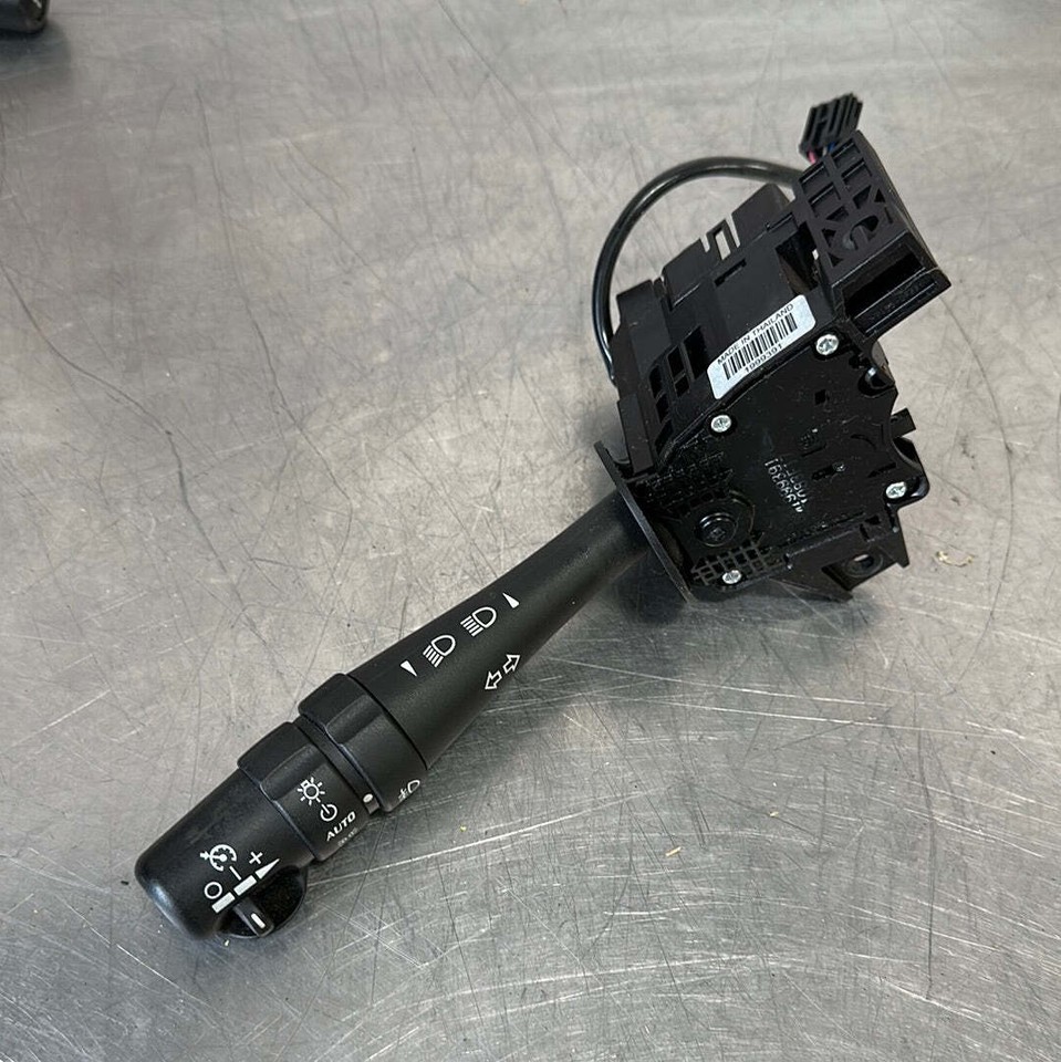

Old Yesterday | 09:00 PM
Dano523's Avatar
Dano523
Joined: Dec 2013
Posts: 12,513
Likes: 3,638
Originally Posted by JetStreamButterfly
is there a plugin tool that can turn them off?
Maybe, but all you need to do once you start the car, is rotate the light **** dial all the way clockwise and let it go, which will turn off the lights as well as the day time running lights as well.
https://i.ebayimg.com/images/g/J0UAA...VM2/s-l960.jpg
Yeah, I don't want to mess with it every single time. Thanks.
