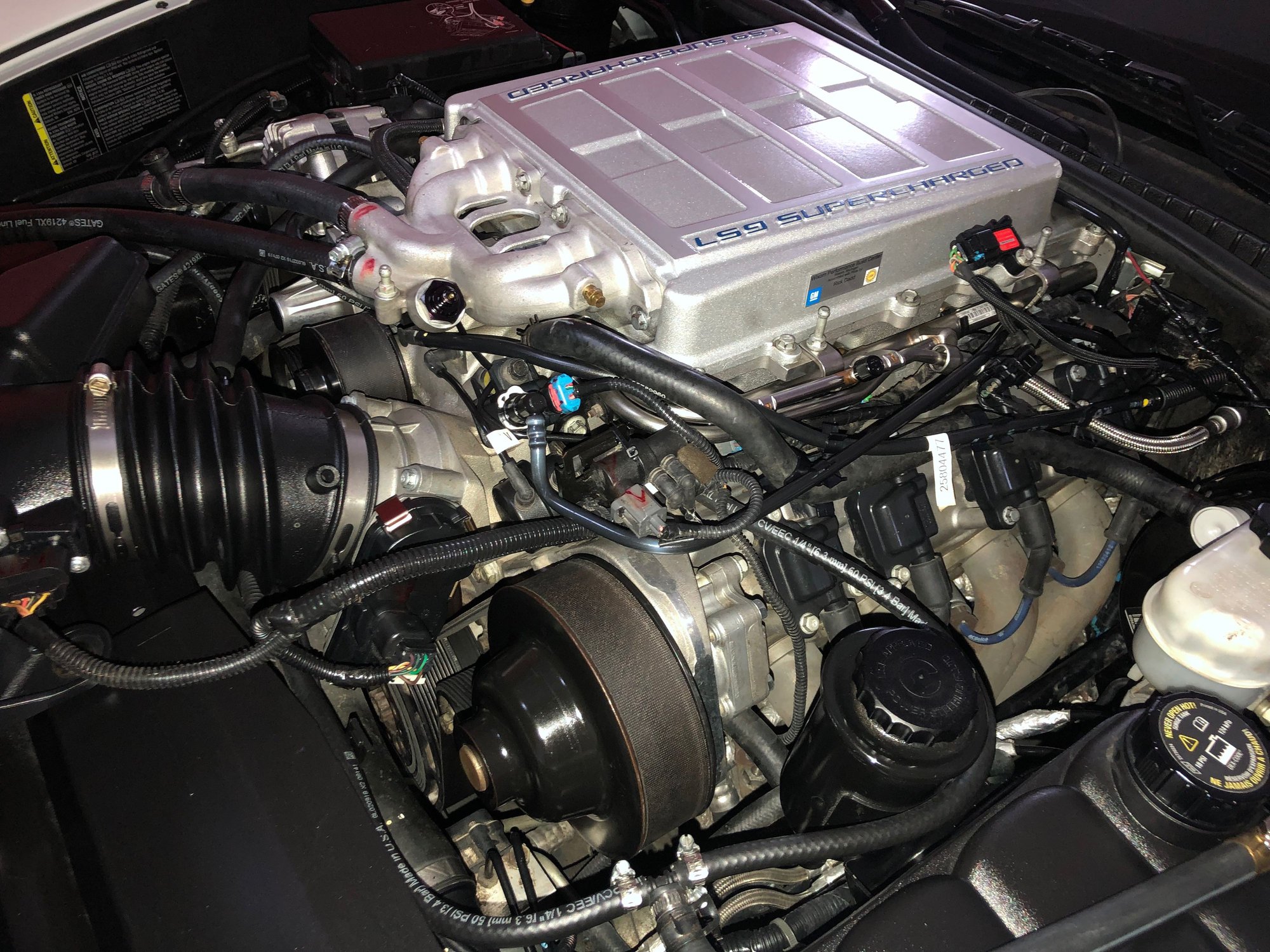

Ok, yes I did contact Greg already. Because the car had a sticker form kong performance on it and I thought that he will remember or keeps a file of the car that he tuned but turn out that he don't. So I have been talking to him for long already. The car had a kong tank too. So I bought that too again.
Here are the pics of my engine.

So that lid has been on/off a bunch, as have a bunch of items on that motor, including the valve covers. If you have not had the lid off yourself, pull it and make sure the bricks have been reinforced. Also, if you have not done so already do a compression and leak down test. I would not be surprised if the blower was ported already. Other questions, how many miles are on it, whats the VIN and if you don't mind saying what did you pay for it?
