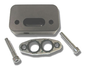

We offer two versions of our adapter.
One for use with an oil cooler (-10 lines):
And one for use without an oil cooler:
We normally modify the oil pan to return the oil to the pan.
