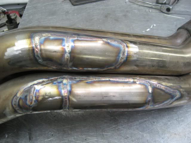

Truth be told I still have my Dynatech 1 3/4's on my set up, even had them repaired not too long ago... lots of BIG speed bumps here in Texas...
So it depends on what your looking for... do you have a methanol kit on the car? or a good F.I cam?
