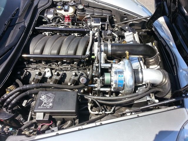

Lunch time fun. Did a 4" inlet to blower at lunch. Blower is way louder and BOVs sound wicked now.

Yep. I've had it for the past 6 months but was still running the factory ECS intake.
Once the TT zl1 is done and the turbo c7, we will do a whole front end rebuild on my car. Cut out the front bar, relocate radiator, condensor, new intercooler, new inlet. For now this works. Car seems to run cooler too. Was 109F on the way home and only got to 225F with a/c on. Before I was seeing 235F by the time I got home. Airfilter isn't wedged up against the a/c condensor anymore so that probably helps.

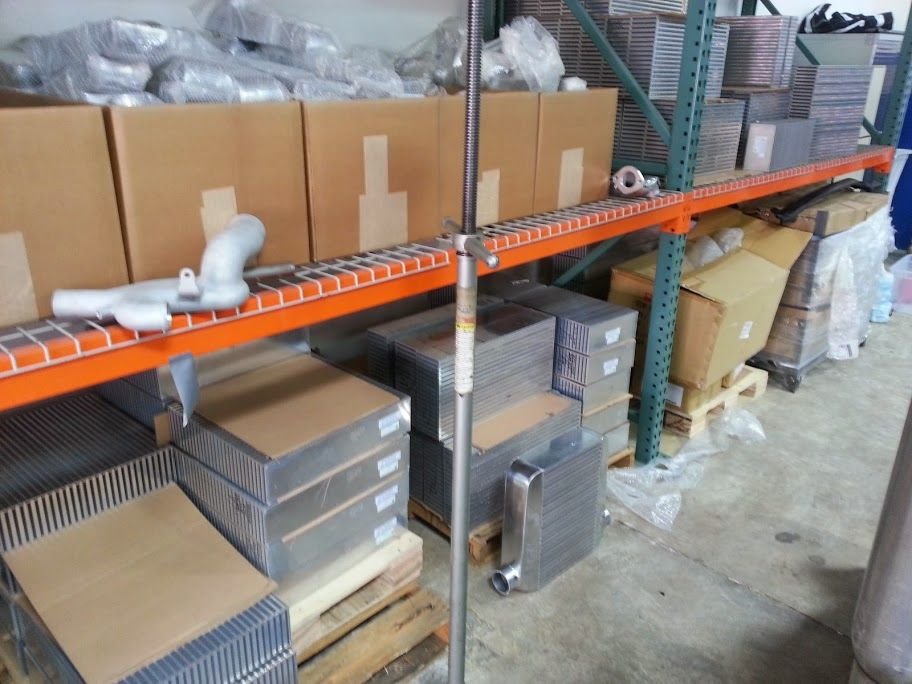

Trying to pick out what core from the wall of intercoolers to use.

I'll ask but it would be easier and cheaper to make one your self. It was a 10 minute job, 2 cuts of a mandrel. All you need is a hacksaw and a 4" mandrel bend and cut it to length.

The cut down radiator makes this easier, just FYI for anyone planning to make one for a stock or stock size radiator car.

No way in hell a stock size radiator would work unless you drop it 2". Might as well use the stock ECS inlet that is fine. Hell I made 1050 on it with filter on.

Driver valve cover to one inlet, other to blower inlet on pipe, and other to behind intake.
