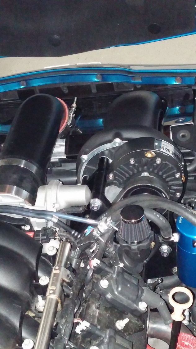

Hi, I believe my engine developed a front main seal leak but I think it only happens when under boost. I noticed a little residue about a week ago so I cleaned it and I have been taking it really easy since it's cold here. Yesterday I got on it a couple of times and when I got home I was changing a bumper extension when I looked and saw it was actually more wet than the last time and it looked fresh too. So my question is what are my options for a better vent system?
I have the ecs valve cover breather, the hose running to the sc filter on the passenger valve cover like ecs instructs and a catch can from the valley cover to the intake using a check valve. Attached is a picture for reference. I was thinking running a hose from the driver's side valve cover and connecting to the same line going to the sc filter. Any suggestions?

So I ordered a mighty mouse catch can and after reading a couple of posts from the can builder I decided to change the way I have the connections. First, I'm going to replace the current catch (elite engineering) can with the mm one while relocating the dirty side to the vent next to the oil cap and the clean side will stay connected on the intake behind the TB with a check valve. Second, I'm going to use the scavenging effect from the supercharger filter and connect the valley vent to it. According to the can builder the valley needs the most help to evacuate compared to the valve covers.
The mm can has a valved breather allowing any extra pressure to evacuate as needed but keeping the vent system relatively sealed. I'm keeping installed the breather/oil cap included in the ecs kit.

I decided to install a small breather on the driver's side valve cover using a check valve. I set it up that pressure will vent but no vacuum will come in. Did not want any unmetered air since it was tuned maf. Somehow I was not expecting the noticeable change in engine behavior and response. Could be on my head but nothing like this ever crossed my mind. Is that even possible? Engine seems to run smoother and much more pleasant to drive at low speeds, cruising, parking lot, etc The slight cam bucking I have is almost un-noticeable. Could this be possible?
