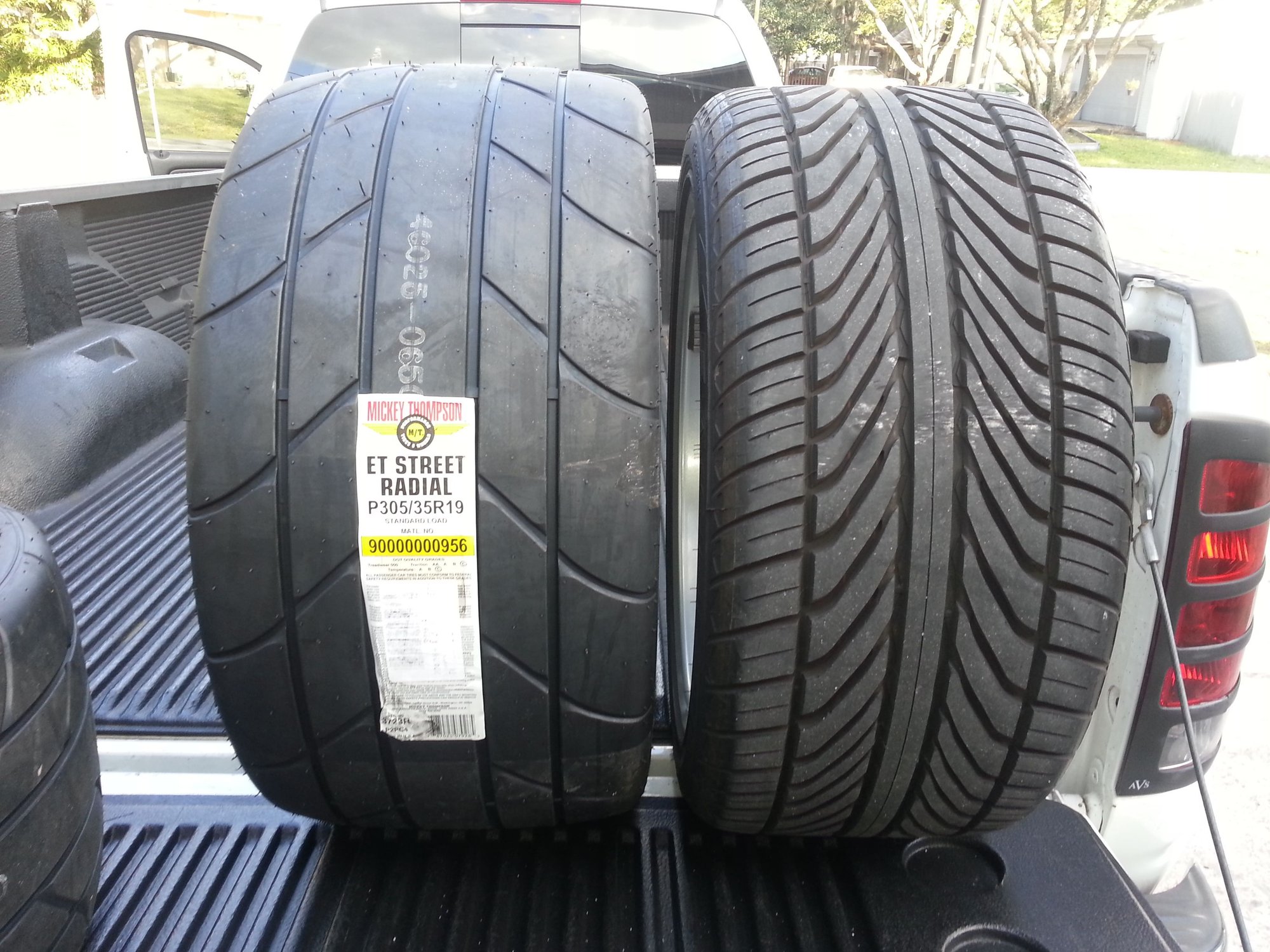

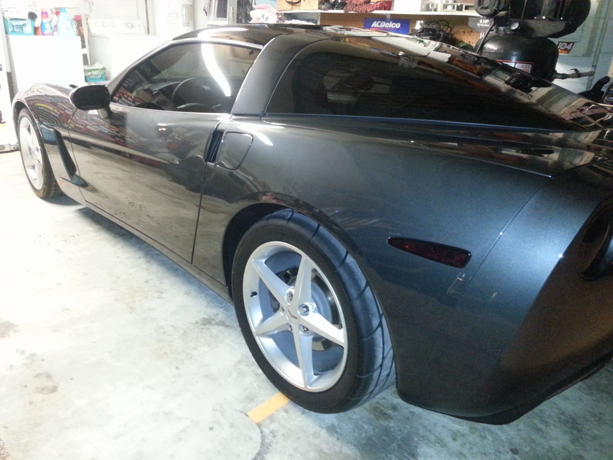

What do you run as a front tire and what size? I throw abs when braking hard with the 305 19s ...do you see any of that ?
Originally Posted by 7SECONDS
I just put 305/35R19 Mickey Thompson Street Radials on my base C6 stock suspension with 755 RWHP. They Work Awesome on the Street!

My M/T Street Radials are rubbing the inner fender Bad at over 140 Mph. The car squats if the rear when it is accelerating and the tires are growing like a Slick at over 140 Mph. Anyone else having this problem or is this a Freak of Nature? I adjusted the jacking bolts today trying to stiffen up the rear. Any suggestions!

Completely normal. I had to raise my car a bit to prevent rubbing at speed. I've seen people with slammed cars completely take out the fender liners and into the battery box.

305/35-19 and they work Awesome. They just rub the rear inner fender almost all the way around at high speeds. I could see them grow during the 4th gear pulls on the dyno between 140 and 170 mph. I tightening up the rear jacking bolts again. Don't want to replace the inner fender until I get this resolved. I was wondering how people slam there car without ripping the fender well out.

Mine fit fine and are great under normal driving conditions or a light to light Street Race. These tires grow on the diameter at high speed like a bias slick. That is were the problem starts.
