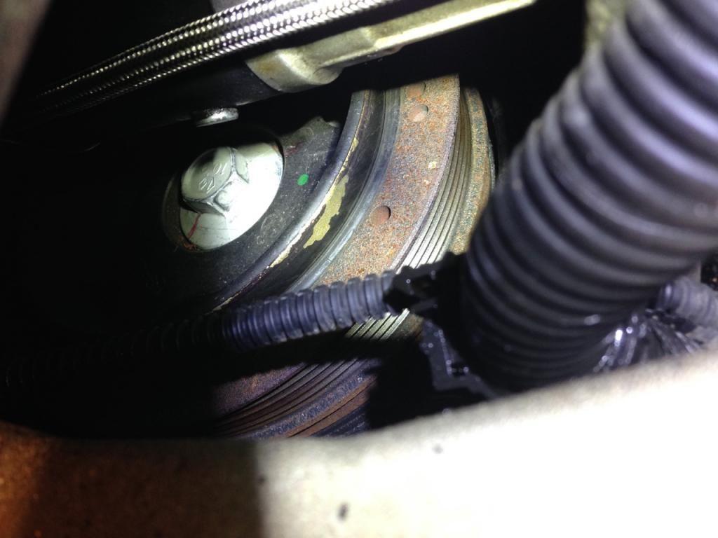

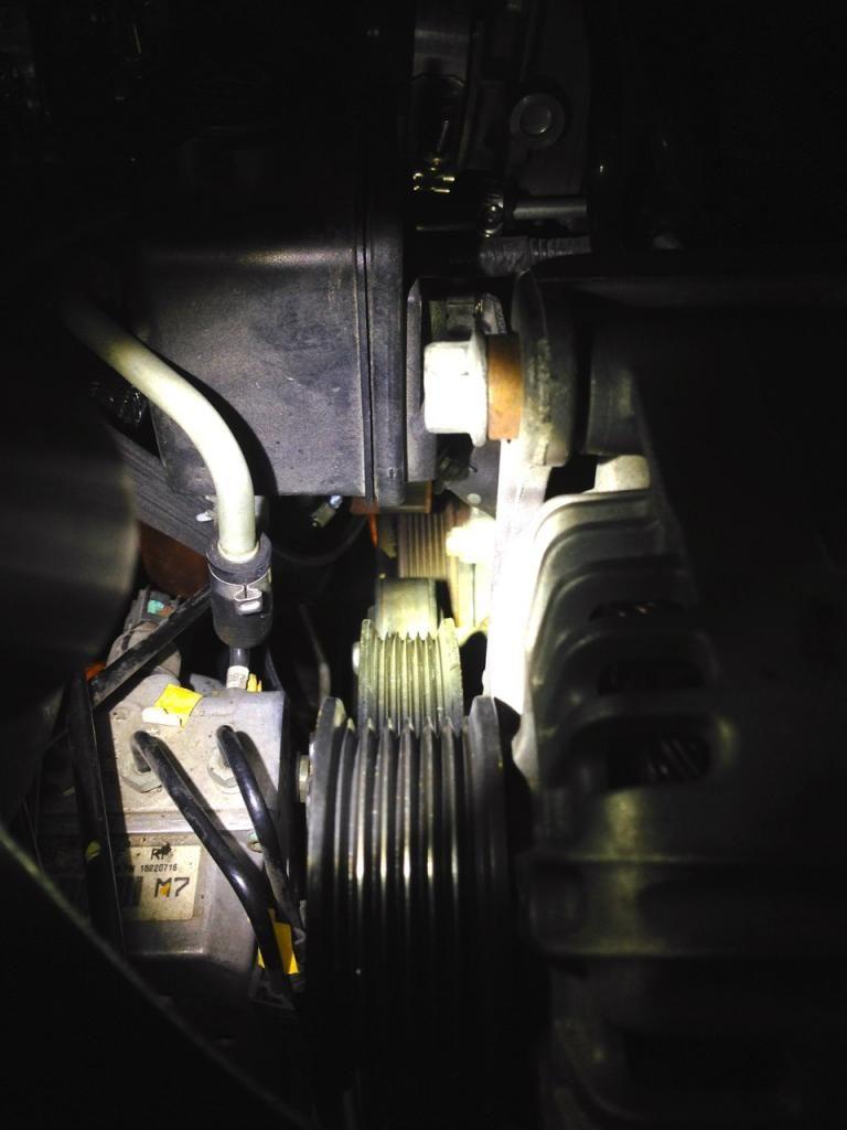

What's your take on causing this damage to the belt?

Alignment..... most probably.

Make sure the ring on your harmonic balancer did not come loose from the rubber making the pulley to walk causing misalignment.

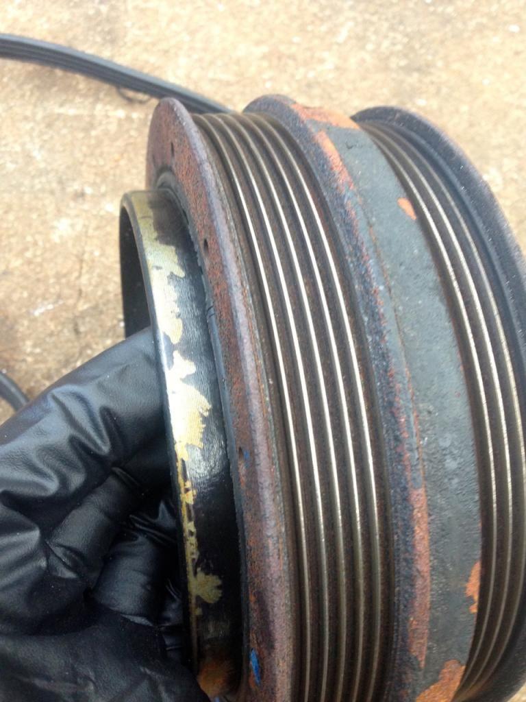

You guys have probably already seen these.. but here's what you don't want it to look like.
Old Jan 20, 2015 | 10:52 PM
7SECONDS's Avatar
7SECONDS
Joined: Nov 2014
Posts: 577
Likes: 15
From: Tampa Florida
Those pictures are what made my decision to have an ATI balancer installed during my build. It may not be his problem but it is something to check before installing another belt.
